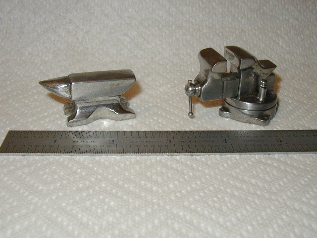

Well I got my tools ready to make a micro cannon but I seriously doubt I could make a working model in relation to the scale of my vise.   My dad made this working vise and the anvil over 50 years ago.
I have a few projects going on now but hope to start on a working nano cannon in a few weeks.
This thread is great!

Great looking tools!  Now with a micro-drill you'll have a set ready for action!

Oh Great! now we have to build scale tools too!  ;D  welcome!
I guess I'll have to dig out my 6th scale drill press, work bench, vice, anvil, engine hoist etc......... before I can start this project...... ;D

Josco, those are some fine looking shop tools. Excellent craftsmanship.
I have a small anvil not much bigger than yours around here somewhere, but it's a store bought replica. It appears to be forged but probably would not hold up to much abuse, more of a whatnot than a tool.
