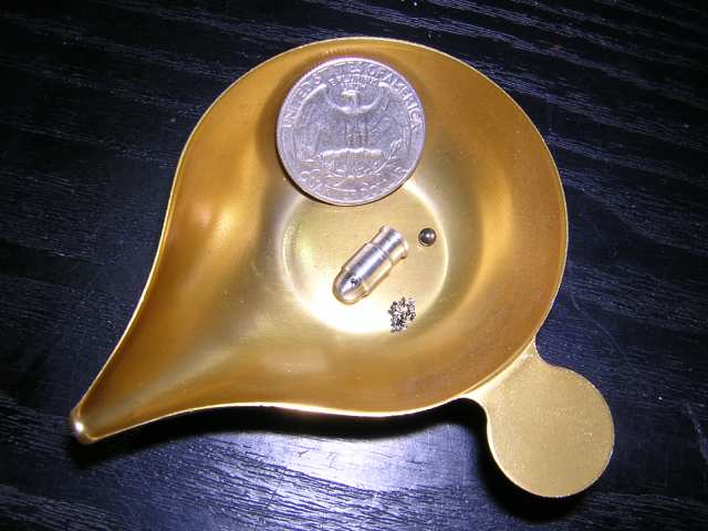

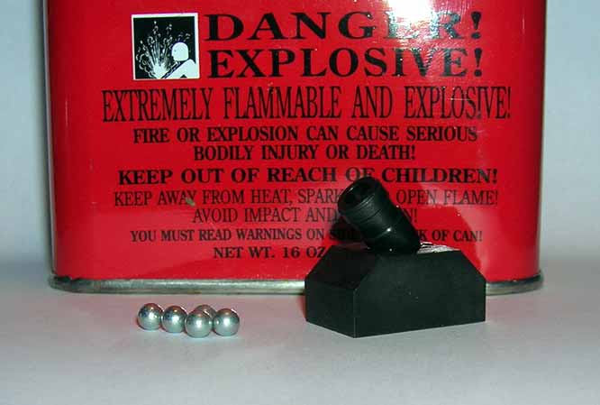

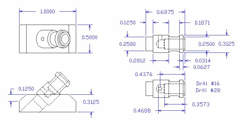

Here is my latest creation.  I got the bug to build something really small after seeing copdoc’s little cannon.  I have dubbed it Nano-mortar.  I have to say it’s as much fun as my big stuff and much cheaper to shoot.
It is 0.177 bore (BB size).  The bed is 1” long.

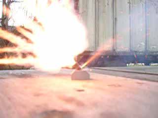

It shoots well thought it’s not much for range.  I got about two feet out of a pinch (probably about a grain or two) of FFg.
The muzzle blast from this guy amazes me.

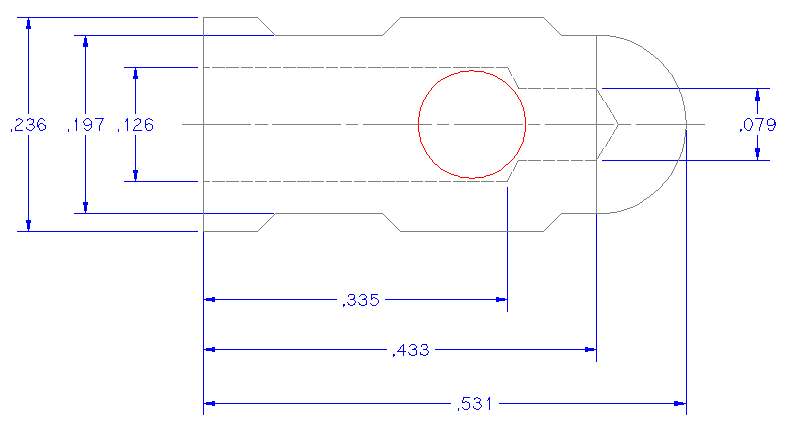

Here is the drawing for those who are interested.  For the most part I stuck to the drawing.  The bed ended up thicke;r all I had was 1/2" steel.  The original plan was to plug weld the barrel on from the bottom.  Since the bed was thicker the drill would have broken though on the end.  I ended up tacking it from the top.  It doesn't look as good but it works well.  I’ll have to make another improved one.

and great photo.  I see why the powder can.  The action photo even looks like a big gun.

A sub-chamber no less!
Looks like something that anyone with a drill press could make... yup... the nano-race is on  :D

The sub-chamber was just because.  On the next one I think I’ll do a straight bore.
Here are a couple of videos.  For some reason I couldn't get youtube to work so I found another video hosting site.  Let me know if it works.
http://www.mediamax.com/cu_cannon

The secret to the action photos is to grab frames from the video.  You can really capture the muzzle flash that way.

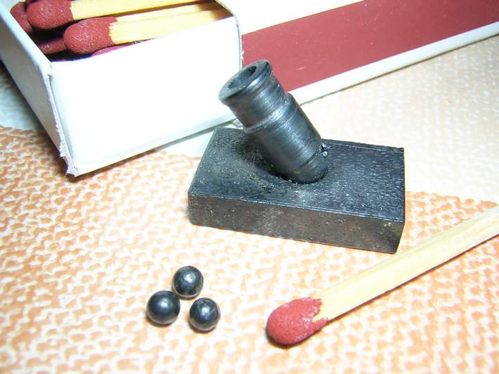

Hi folks!

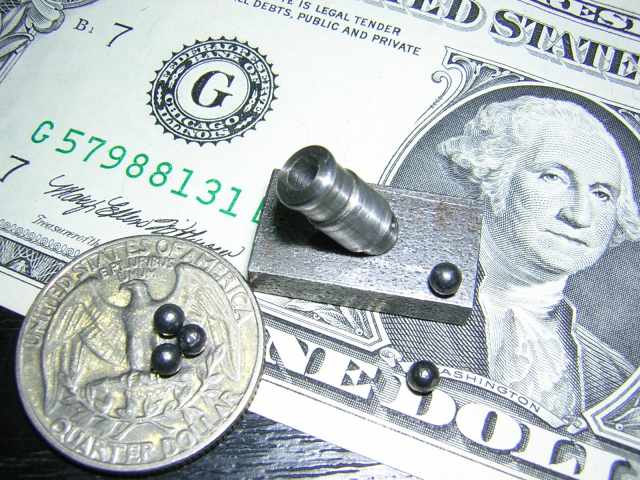

This is my first contribute to this forum but I watch the (bp mortar & cannon) discussion for years by now.
I am in the final preparations to build a golf-ball coehorn mortar. The calculations are done and I am pretty positive that it will be ready in late January. For a better understanding: I do not own a lathe, nor do I come from the metal machining business, so I need some help of a friend of mine for that.
Anyways:
After the Nano-mortar post from CU I felt the need to build my very first mortar NOW.
(yep DD, the race is on... Must be possible to get even smaller?)
It is solely done with a drill-press some files and emery paper.
Please excuse the rough appearance: I wished I could have used a lathe.
This mortar is designed to fire 3 Millimeter shotgun shot pellets (0.118 inch diameter).
I have been given those to melt down into bullets, but I found them to be pretty consistent in size so I kept them for a better use.  ;D
The bore is done with a 3.2mm drill (0.126 inch); the mortar has a 2mm chamber (0.079 inch) for a maximum load of about 0.2 grains of black powder (Swiss #2).
The mortar will be welded onto the base (tomorrow), after that I can report how far the trajectory drives the shot.  ;)
Sorry, but I do not own a GOEX can, so I placed a dollar note and a quarter in the photos for size reference.
Jorg
(from Germany)

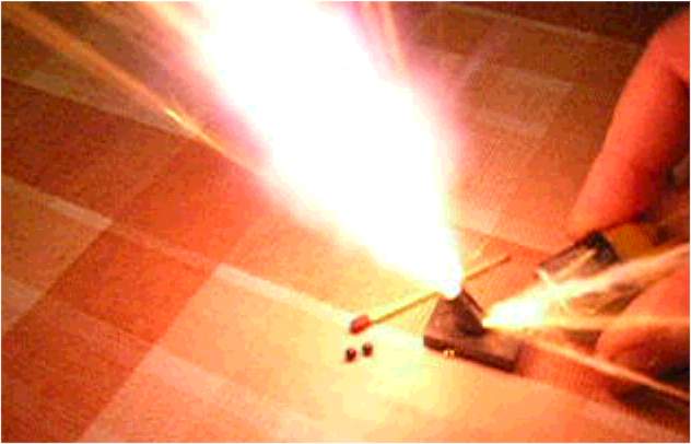

I just finished test-firing the pico-mortar. And it does work!
But first an update on finishing this little beauty:
After welding it to the base (being done from the bottom, by filling a bored hole: this way its not visible AND possible at all) the mortar was that hot, that the bluing in oil did work out fine. Just take a look at the picture below (ready for firing):
Anyways. I started with a load of about 0.2gr Swiss #2 but this did just a sizzling sound, so from the next shots on I used Swiss #1 (which is even finer in granulation: about 0.011 to 0.015 inch) which produced a nice snapping. :D
For Rickk and CU: The touch hole is 0.5 millimeters = close to 0.02 inch (that makes it about 16% of the bore diameter (if one may still call it so).
Priming was done by filling the touch hole granule by granule; sweaty hands help maneuvering these tiny particles in place.
First I wanted to enlarge the touch hole to fuse diameter and keep the rest at the smaller diameter (to keep some pressure) but the wall thickness is that small, that this was not possible.
Ignition with a lighter proofed to be better than trying to do it with a match: the flame produces soot but therefore does not function (kept them as size reference on the photo though).
Whatever. At first I thought that the shot would barely leave the muzzle: wrong!
Firing from the kitchen table I shot dimples into the door! This was 2.5 meters (8.2 feet) away! By the trajectory (angle of the mortar and height of impact) this means an estimated firing distance of 6 meters (about 20 feet): I would never have guessed this to be possible with a piece that has a barrel length of just 8 millimeters (0.315 inch).
Boy, does this little is fun to shoot with!
I did take a small video with my camera as well (bad resolution though).
The muzzle blast is most impressive taking in respect the tiny load.
By the way: the video is about 2.1 megabytes (*.mov-file) and it would take me ages to upload (I surf the web just with an analog modem still), does anyone know a tool to cut the important part out of the file (and/or convert it to be smaller in size), so that I may provide it?
I need to do a cannon the next time...   ;D ;D ;D

The wall thickness itself (at the fuse hole) is about 0.062 inch. A touch hole that size just would not fit into scale (and I would loose a good amount of pressure).
Yep – Dimples is plural. Who said that I stopped playing with that toy after the first shot? ;D ;D ;D
And keep in mind the caliber: those dents fit quite natural in the wood grain structure!
Nope: I am not married and ontop of that, I believe I am the first one of this board who actually fired a mortar in the kitchen (more than once, besides accidental discharges).  ;D
For your interest, I added the blueprint of this mortar.
With the outline I had some difficulties to get it right (due to the lack of proper tools). The bore depth and diameter are true though, as well as overall length and diameter. By the way: those odd numbers appear more sensible in metric.

And thanks for the info on the PM: I was not aware of that! Since I have got an informative PM I wanted to reply on that; but now I know why it did not work out.
Back to the mortar business:
I found some other free webspace provider; I hope it works with you.
Here is the video link of my "pico-mortar" firing:
http://www.fileupyours.com/files/74852/picofire.avi
I have heard from a guy who hunts feral cats with a coehorn, must be challenging to smack flies from the wall with mine.  ;)
By the way:
I need to thank as well all of you guys for the good information and inspiring ideas you share!
It took long for me to actually participate but I look happily into the future on all those possible projects we may come up with.

This morning this was an ordinary  3/8 inch bolt...
now it's a NANO-CANNON  :o
No carriage yet, but I fired it already... blank charge - a pinch of 4F and a toilet paper projectile.
Now I know what only the others who have made one know... what the tremendous roar they make sounds like  ;D
Bore is 3/16 (.186), so it will take a BB. Fuse is 5/64, so it will takes 1/16 fuse.
Trunions, as well as cascable, are 3/16 inch steel rod pressed into shallow 3/16  holes and then brazed in place.
All the work was done on my drill press, with some help from an angle grinder and a file for shaping.
It needs a pit more polishing, but I just couldn't wait to fire it ! Total time into is so far is about 2 hours.
