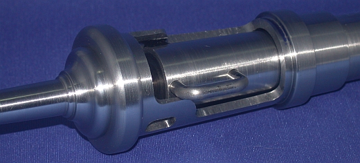

« Reply #153 on: March 12, 2008, 03:52:32 PM »
That bluing really did the trick and we both are impressed with the internal threaded tiller locking feature.  We might have to borrow that for a full-size gonne we are planning for a future build.
Actually, it was Victor's gonne that inspired the idea. After I saw his threaded tiller I thought "I wish I'd done something like that!" I had to go back and re-examine my design and figure out how to thread the tiller onto the gonne with no threads cut into the socket.

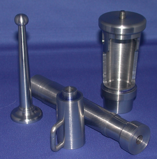

Firing my micro-gonne was a somewhat time-consuming procedure because I had to weigh out each charge individually. The smallest scoop in my Lee kit throws 4.8 grains of FFFg and overfills the chamber, which has a capacity of 2.5 grains.
I've loaded the gonne with charges close to what the Lee scoop would throw when shooting the plastic AirSoft pellets, which weigh only 1.69 grains, but when shooting the lead pellets (19.63 grains) I want to keep the charge within the confines of the chamber.
Weighing and handling the minuscule charges was a pain. What I needed was an easy to handle volume measure with the same internal dimensions as my chamber. I finished my work a little early today, so armed with a chunk of scrap aluminum and a little too much time on my hands, I came up with this:
The entire measure is machined from a single piece of aluminum. The dimensions are incidental, other than the powder cavity everything as eyeballed. The overall length of the measure is 3.054". The handle is .547" in diameter. The handle was roughed up with some medium emery cloth while still in the lathe, to give it a more positive grip. No other finish work was done, although I may buff it out with some 0000 wool now that it's been tested.
The cavity mimics the dimensions of the gonne's powder chamber, so theoretically a full measure should exactly fill the chamber.

Speaking of measures, I never posted a pic of the brass measure I made for the Pullen micro-mortar. I haven't shot the little mortar in quite some time so the measure has been hidden away, almost forgotten. I dug it out when I started experimenting with the micro-gonne and the plastic AirSoft pellets.
Here it is, all shined up, next to the new aluminum measure for the micro-gonne. Made of brass scraps, it throws a 3.5 grain charge of FFFg.

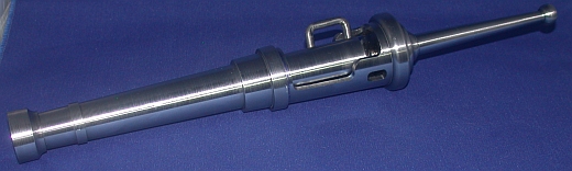

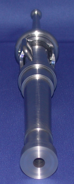

So, I want to play this game too. I saw Cat Whisperer's post:
"I would like to have a swivel gun in fire-cracker caliber for back poarch and bar-b-que party entertainment. "
And I decided I wanted a swivel gun that I could shoot firecrackers off the porch too. (It helps that they are legal here). So I looked around and found this swivel gun:

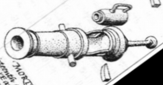

So I made a set of drawings, and this is how far I've come:
I still have to mount the trunions and make the "key". It has a 5/16 bore in order to shoot firecrackers and it is all cut from 1144 stressproof so I figure it should hold together with a 10 grain charge :)

Re: Nano-mortar
« Reply #169 on: March 24, 2008, 12:48:18 AM »
SHAZAM !
You don't KNOW how jealous I am!
Of course, you'll need to send it to one of the moderators of this board for proof testing and life-time testing!
Breechloading too.
I've found that just a pinch of 3F will get a BlackCat out about 30 + feet with a bore that's 2" deep and just large enough to slide the firecracker in it.  I use the same fuse cut from the firecracker too - that means a really small fuse hole.
