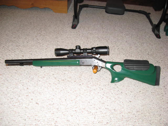

I have a Nikon prostaff 2-7x32 on my 20ga USH
I used the Weaver quad lock from walmart (i know), the Medium hight are the ones I used, I had to extensively bob the hammer to clear.
On my side kick I have a Bushnell 2-7x32 with the "high" quad locks, only very slightly higher. on this I had to bob the hammer and it was still a tight fit.
If I had to do it again I would use the quadlock "high" rings with the Nikon, even though these are labeld "high" they a quite low.
Here are 2 pics of the side kick with the Bushnell 2-7x36 on the Weaver quadlock "high" mounts.
Nicholas Andraka

Also, the prostaff 2-7x32 slug scope has ~4" eye relief, so it is setting forward a little, and the hammer ends up under the "bell"

It's a knee pad from HomeDepot (lowes does not have this style), cut to shape and epoxy'ed on, it's made of some super soft rubber, and puts my eye perfectly in line with the scope.
That said, are your gonna, epoxy it on a $500.00 gun ?? Thats why my guns are made for function period, "2nds unfinished" stocks, painted with Krylon, barrels cut down, hammers bobbed, etc. Gotta love the H&R's
