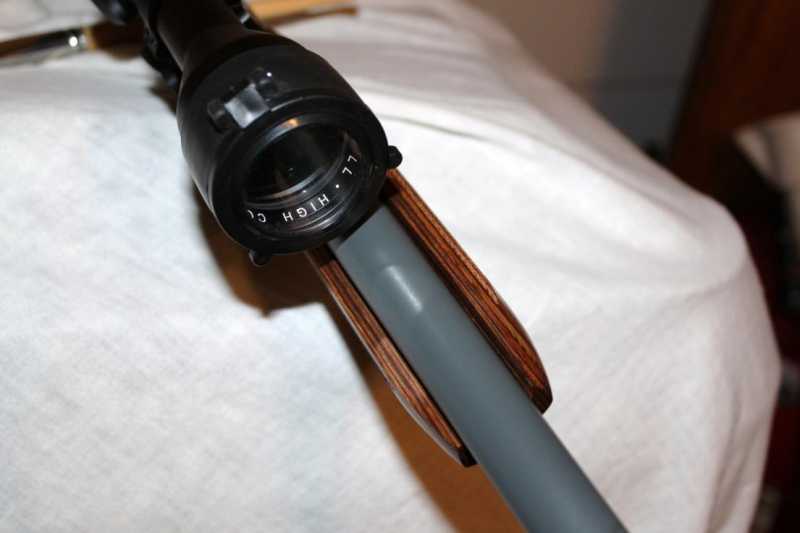

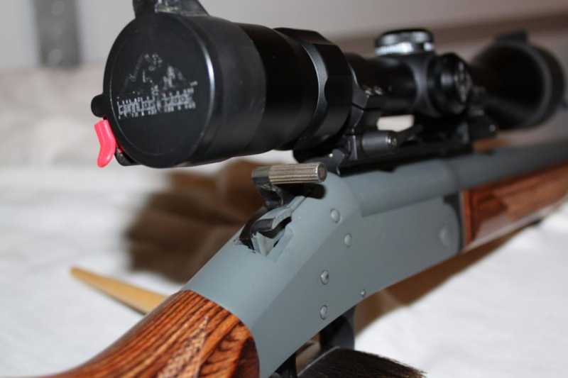

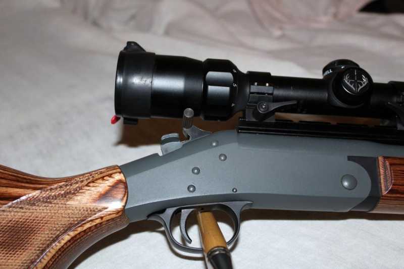

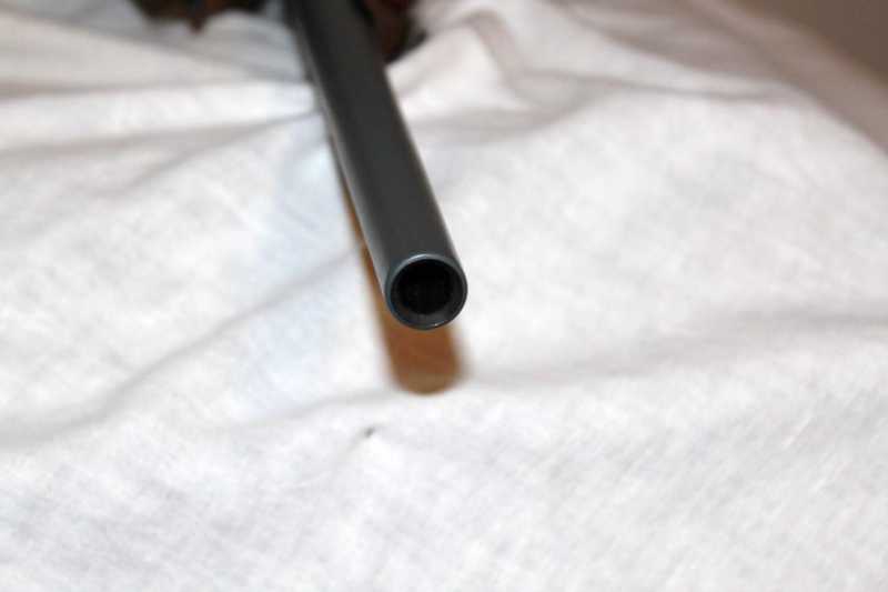

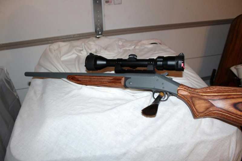

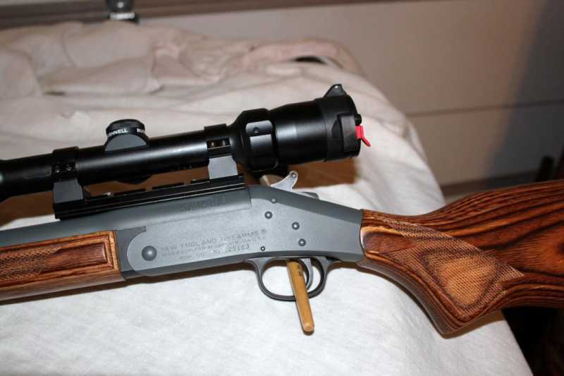

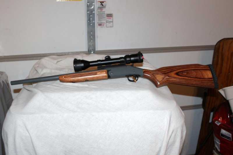

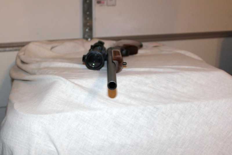

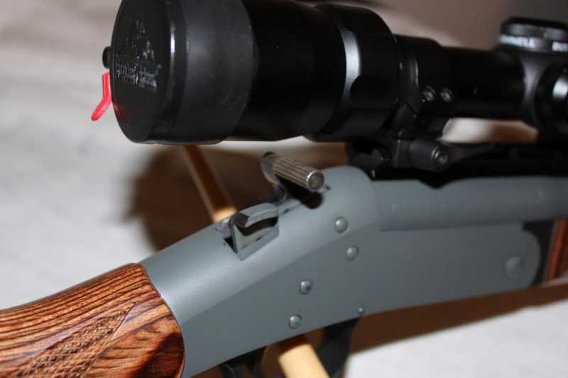

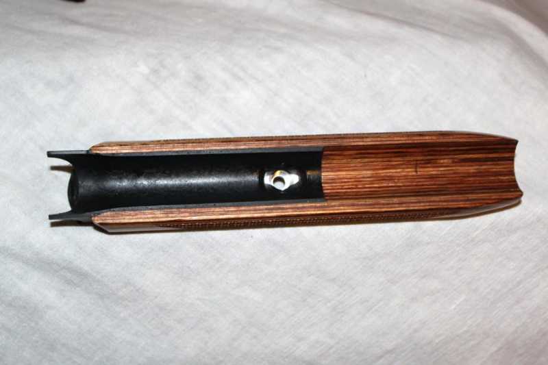

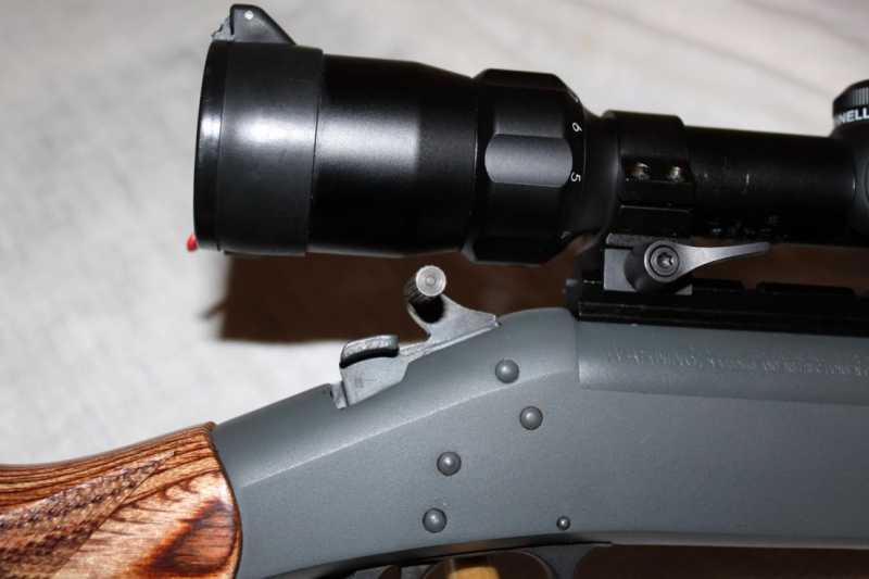

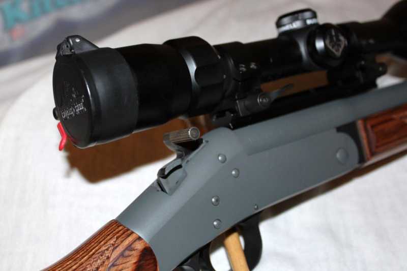

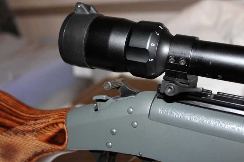

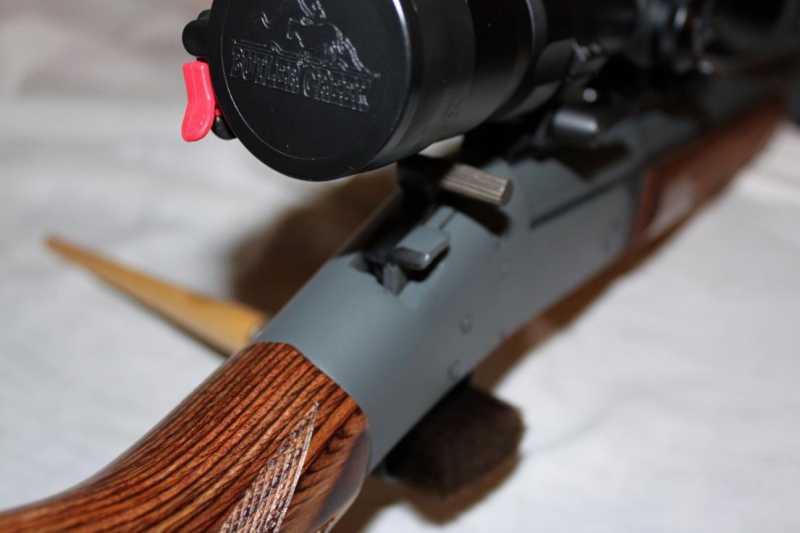

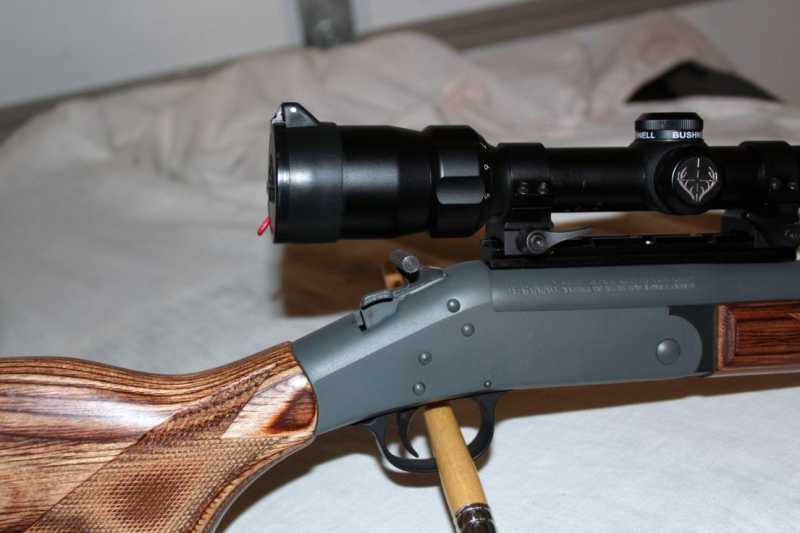

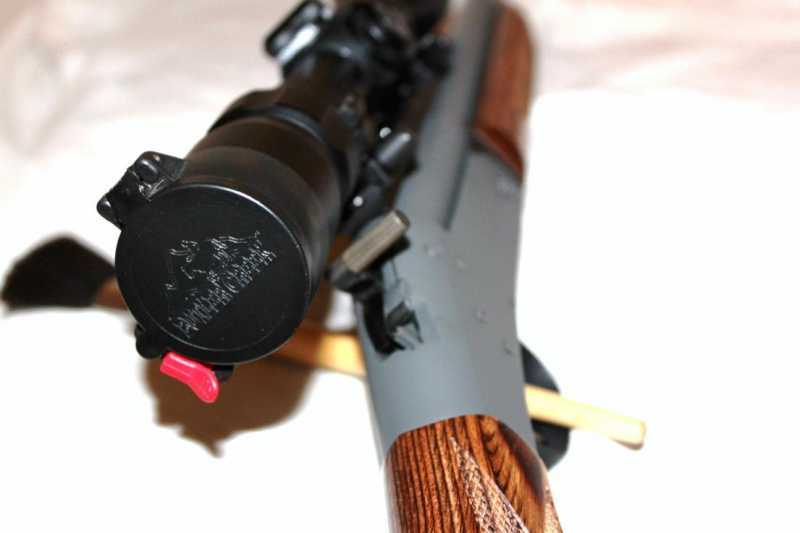

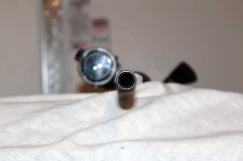

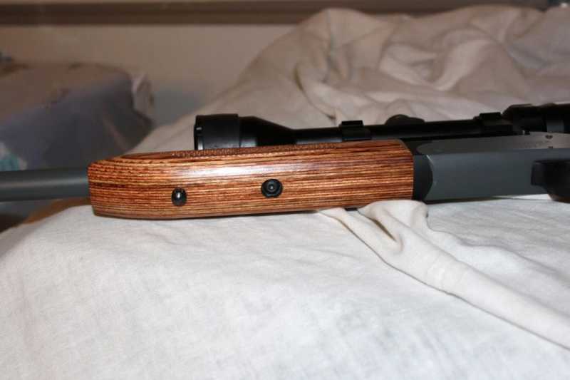

Pics as promised. Before anyone asks, the work was done by "The One Who Has To Remain Un-Named." ;)
Thanks, Dinny

Nice looking rifle Dinny! Like CW said, try some 300 grain jacketed. I've had good luck with the Sierra 300 grain JSP.

My money is on latch engagement/fit too. ;D  I got good and Ok accuracy at 100yds with Lil'gun and the 250gr Speer and 250gr SST which is the same as the FTX before it was an called FTX!  ;) The Speer was the better of the two.
Great looking Handi Dinny!  ;)

Once again, you guys were right!! My latch engagement was less than 30%. I started stoning the latch last night around midnight and finished just after 0200. Now it has better than 70% engagement and shows good rub marks straight up the middle of the latch instead of on just one side/corner. I got a set of low rings in the mail today and my big fat Bushnell Trophy rifle scope still fits with the lower hammer. I will have to wait a few weeks before I can shoot it, but in the meantime I can work on my reloads for testing.
Thanks for the tips!
