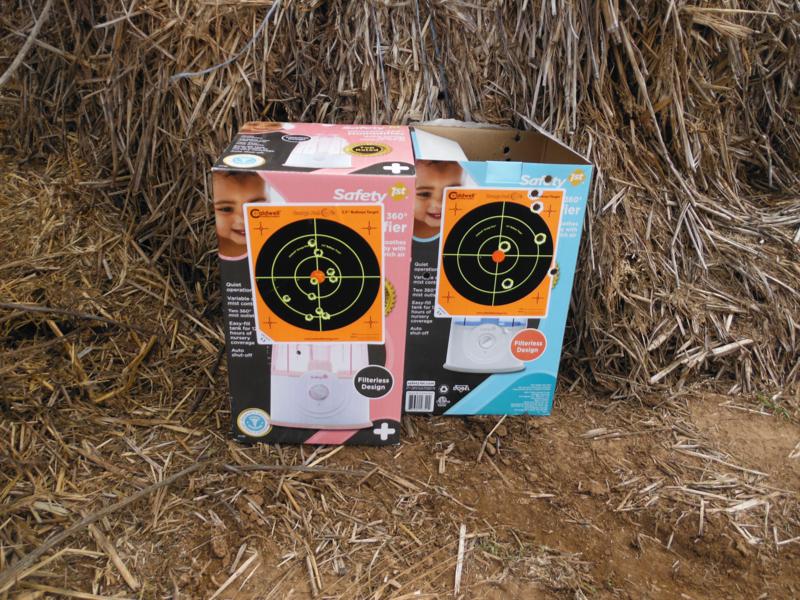

« Reply #59 on: March 13, 2013, 10:34:37 AM »
Yesterday I changed my scope to a Nikon Monarch 3-9x40. The sighting target (on right) looks like it was hit with buckshot. I may have scope issues as the windage adjustment knob would stick and require more force to rotate, often giving me 8-10 more clicks than I wanted. The last shot fired was in the center. Since I only had the 9 shells in the ammo carrier with me, I didn't get to confirm a true zero. This is the group at 95 paces.
I need to go back and read through this string of posts if I'm still having problems and the scope has been ruled out.
