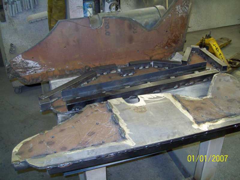

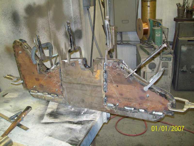

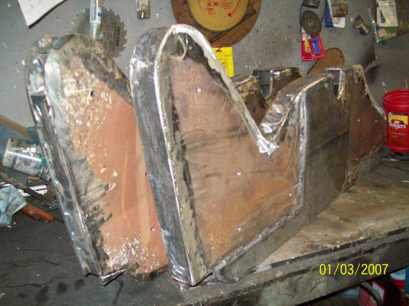

Well, I got a little more done on it.
I'm about done welding on the barrel, except for making the 2 small pieces that go from the trunion up the sides at the rear.
The rest of the 'smooth/cast look' I'm trying to get for the base I'll do with a polyester filler.
The 4 sides of the sled are cut out of 1/4" plate.
I'll be making a inner framework between them with 1 & 1/4" square tubing,
with a band of 2" flat bar going around the edges.
For the inverted "T" looking panels- also in 1/4" plate,
they'll get a framework of 1/4" square stock around & inside them so that the panels will look 1/2" thick.
For now- the next step is drilling the 8 bolt holes going through the sides,
bolting all 6 panels together and grinding the edges so they that all are exactly the same shape.
I used a plasma cutter, and the outline/edges have a few dips & doodles...
This thing is comong up to be pretty heavy.  It feels like about 300 pounds so far.
There's plenty more still to add- all the plates in between the sides, and the 2" band around the sides.

A little progress---
The sides are 1/4" with 1 1/2 tubing & angle to spread them apart.
With the thinest 2" flatstock I could get-- a little less than 1/8th" welded all the way around-
And a little Bondo before its painted,,,,, it will look like solid 2" plate.
In a few days, I'll be cutting out the plates for the middle section.
I'll make the middle part out of steel plate, then glue a 1/4" Oak veneired plywood over them,
so they look more like the original.
I'll scrounge the Brass somewhere and screw it down on top of the plywood.
Somewhere along the way- I'm not sure how it happened, but:
The big "U" where the trunion sits may be farther back than it should be.
I'll test fit the barrel next week and see.  I can cut & move it forward, but I sure don't want to.
The weight is sure adding up.
Each of these side plates feel like about 120 pounds, and the barrel has got to be about that much also.

I think that the seat for the trunnion looks to be in the right spot. As long as you have it about centered on the carriage and space on either side to accommodate the cap square with fasteners.
Offline Winger Ed.
  • Posts: 80
Re: Winger Ed's Winter projects
« Reply #29 on: February 14, 2011, 08:02:40 PM »
I sure hope so.  When I made the graph/grid deal and enlarged it, I ended up with 1/2"= 4 1/2" upscale.
Then made a plywood template as a pattern to cut out the steel plates.
I propped the barrel up on wooden blocks to determined where the trunnion seats would fit the barrel leaving about 3" for the elevation knob and have a few threads showing.
However- looking at other ones, it appears a little more to the rear than 'normal' for when the barrel is parallel to the uphill side of the carriage that holds the elevation screw.
