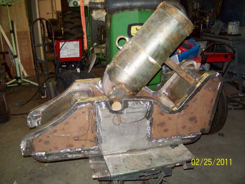

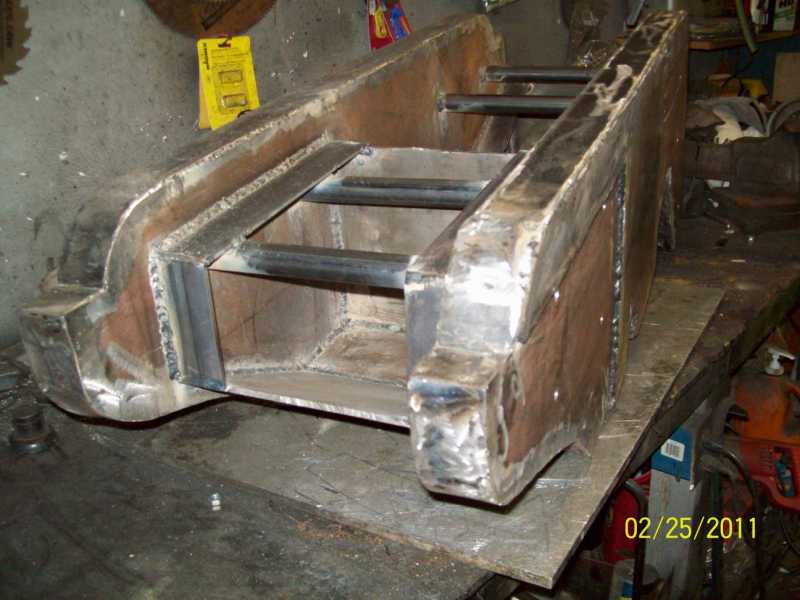

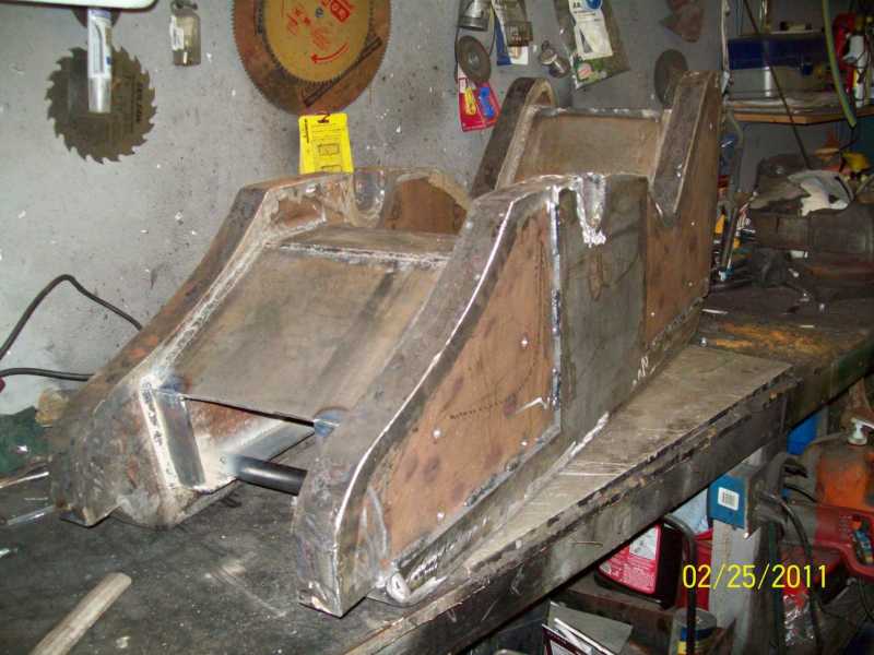

A little more progress....
I guess trunion caps and a elevetion screw is next.

I've read that there has to be some sort of 'keeper' to prevent the barrel from flipping over under recoil.
I think I'll put some sort of short collar on the tube for the elev. post to go into, and have a pin go through them both.
The elevation would lock in at half turn increments- but it should work OK.
Use friction tight cap squares on the trunnions.  Not only will they keep the barrel from rotating, then will keep the barrel from bouncing of the carriage when fired.
You can see them here on my Dom Dictator.  I don't believe the original dictator had them. It's a safty thing

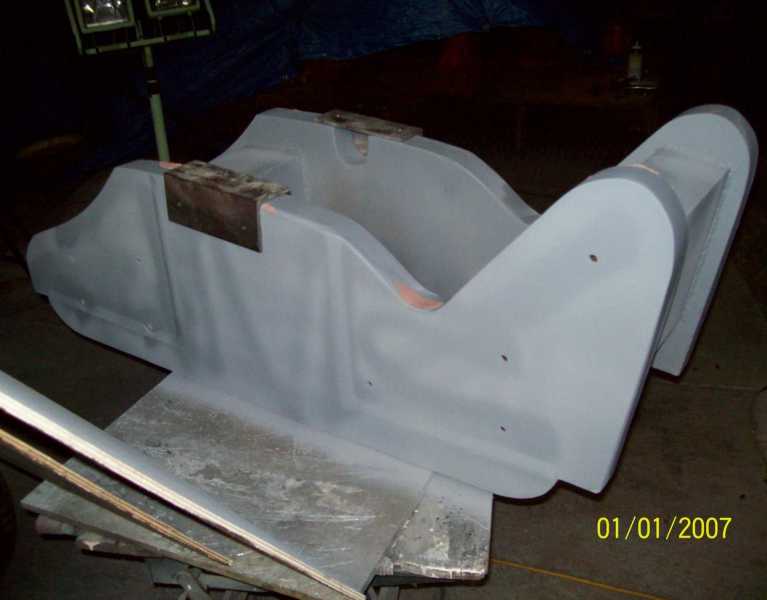

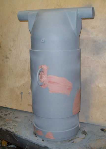

I've had a chance to work on the mortar a bit more.
The barrel just didn't look right, so I added a few inches to the middle barrel band.
The extension was cut from the bottom part of the gas cylinder.
I'm happier with the overall look & shape now.
I'll never be able to get the cast Iron- 'soup pot' look, but hopefully it won't have a,
"Hey, that looks like a chopped off welding tank" apperance either.
Trunion caps are done, they're 1/4" angle stock, and the top & sides of the sled are tapped for bolts to hold them down.
A little more than 20 pounds of welding wire later, & a little Bondo;
I've gotten it primed, and almost ready to paint.  I hope to paint both pieces this weekend.

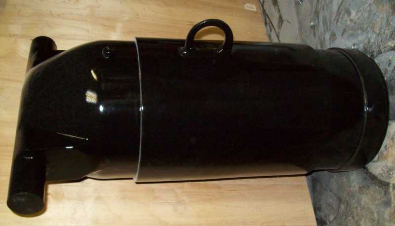

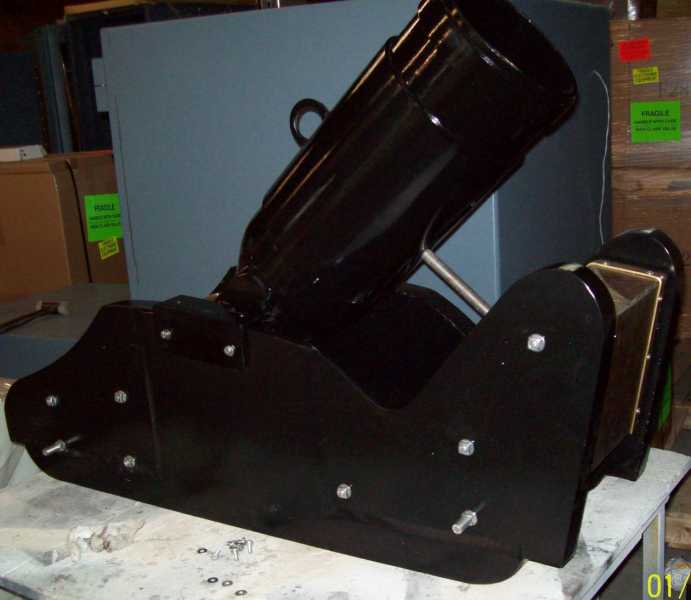

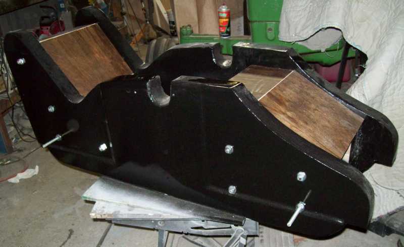

A little further along.......
The barrel looks OK in gloss black.
But after I finish the wooden covered mid-section- I think I'll strip the bolts back out of it, mask the wood, and repaint it flat black.

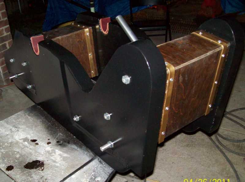

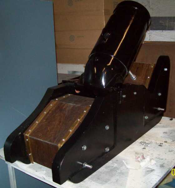

Whew!!!  Its done.
I'll dig the engine crane out and put the barrel on,, hopefully tomorrow.
The elevation screw is a length of 3/4 Stainless 'allthread' rod.
I cut a piece of 3/4 Copper tubing and painted it silver to slip over it while its not being fired.
The inserts where the trunion sits are 2" wide brown (not red) harness leather.
The leather tightens the trunion up just right, and the trunion caps will cover it.

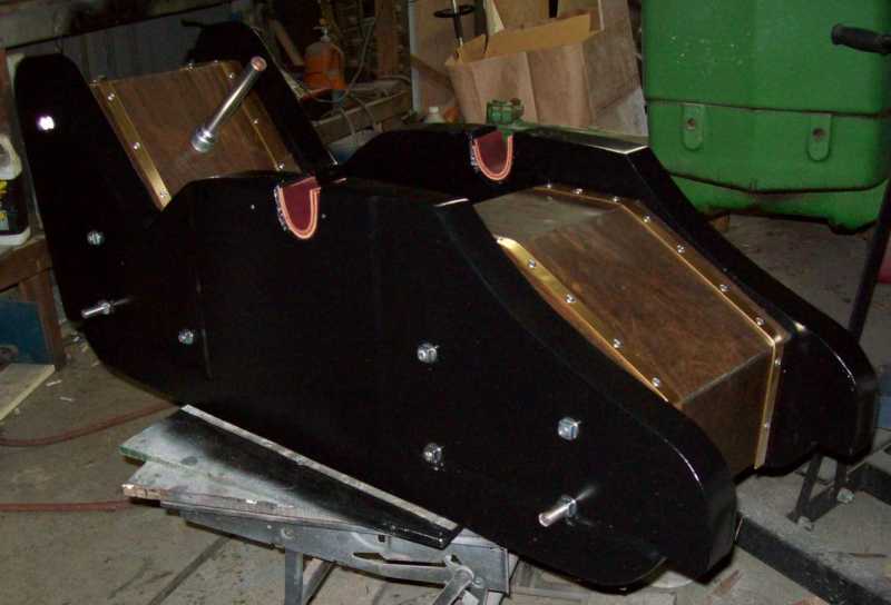

« Reply #50 on: May 02, 2011, 07:10:33 PM »

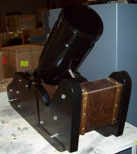

Well,,,
I still have a few little finishing touches, I guess there always is-
Thanks again for all the help.
I'm gonna call it done.
When the storms break, I'll take it outside and get some better pictures, one with a powder can-
But this is pretty much what its gonna look like....
