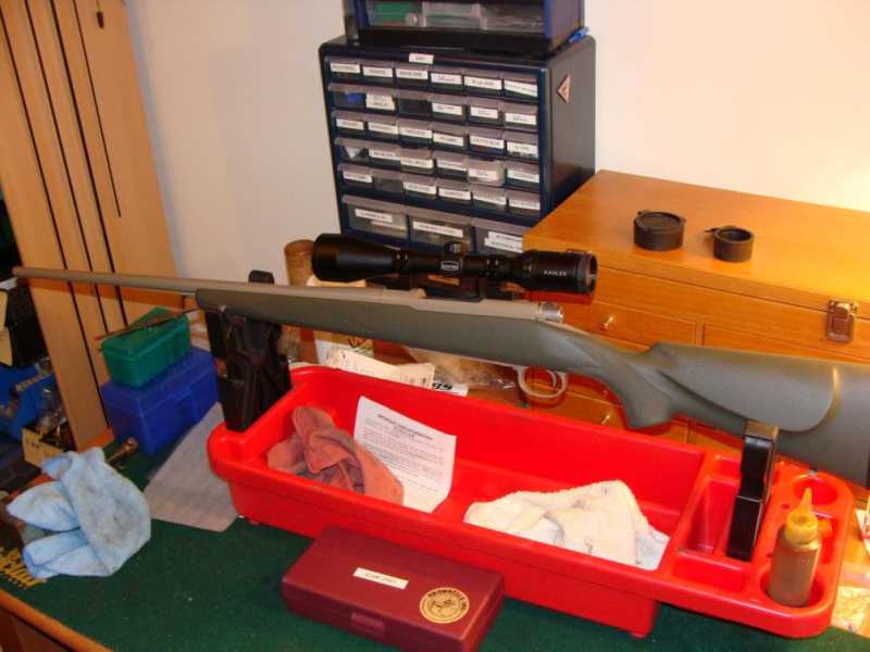

It's called Rustolium.  Textured paint for the metal, feels like it has sand in it.  Accents Paint for the wood makes it look like a rock.  Works for me.

Rog, isn't that the rifle that spent some time at the bottom of a river before it got that nice finish?

Yes Tim, that's why it rusted.  Still shoots just fine, no water got into the chamber or barrel.
I've also done that to my Ultra .223, and a Mini-14, only they are white.
