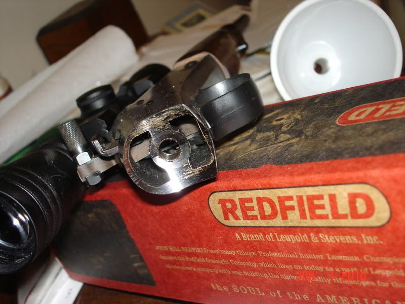

I bought a used handi ultra varmint .223 not long ago.  I finally put a new Redfield 2x7 on it, bore sighted it and took it to the range, really looking forward to shooting this rifle.  I fired about 5 rounds then had a misfire.  I waited a minute keeping it pointed downrange and when nothing happened I drew back the hammer and it fired.   When the brass ejected I looked at it and there was a hole in the primer.  I tried several other rounds and still no fire.  I was using winchester white box ammo.
Anybody got any thoughts?  Did I break the firing pin?

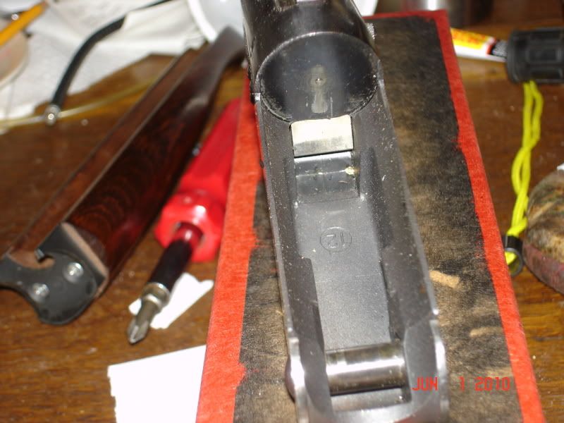

Offline TonyS
  • Posts: 32
Re: Broken Firing Pin?
« Reply #23 on: June 01, 2010, 04:09:05 PM »
Ok Tim,
I have read your explanations, seen the pictures you posted and now dissembled my gun. The guy I bought this from claimed to have shot it repeatedly and developed a handload for it.  Here is what I found:
http://i29.photobucket.com/albums/c265/tanganyikanhunt/Hr223002.jpg
http://i29.photobucket.com/albums/c265/tanganyikanhunt/Hr223001.jpg
I spoke again to H&R today and was told that I have a 1995.  They will not put anything on this frame but a shotgun barrel.
What do I have?
Oh, and since it was asked previously above, when I ordered a new firing pin, the guy gave me no trouble at all and said they are easy to install.  He took my credit card number and gave me a confirmation number.
« Reply #24 on: June 01, 2010, 04:19:24 PM »
What's the frame serial number prefix? H&R won't fit anything but shotgun, 357 and 44 mag barrels to '96-'99 frames, it's possible some late '95 frames were also outsourced and the cutoff isn't exactly 1996. It's definitely an SB2 frame, so unless it has a defective firing pin, it's not likely the firing pin size that's causing the issue as it would on an SB1 frame, may have just been defective primers too. Beats me why the CS rep took your order for the firing pin, it's clearly marked restricted in the owner's manual. But it's not a first for them giving out incorrect information, you may still find out it can't be shipped to you, that kind of screw up happens all the time in Madison customer support.  :-\
http://www.hr1871.com/documents/manuals/new/Handi-Rifle.pdf
