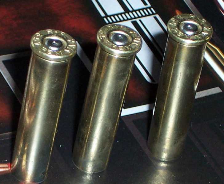

One thing though, I may have overpressure problems with this load:
These are the first abnormal looking primers I have seen on my handloads.
Load specs are 140 grain XTP's over 23 grains of W296 with a COL of 1.890"
Winchester small rifle primers were used and the bullets are lightly crimped.
Also the cases were sooty which is usually a sign of low pressure if I am correct.
As you can also see the 357 mag cases look fine. They also grouped well at 2 inches.
Could the fact that I have the Sb1 receiver have something to do with this?

These are the 1st three fired from my recently reamed SB1 .357 Mag to Max.
Can't see any problems with the primers at all. They look the same as the .357 Mag. that have been fired.
Loaded with Sierra 158 gr. Sportsmaster JHC
R-P brass
17 gr. H-110
CCI-450 Primers
Heavy Crimp
Bill

Jeff:
I had sooty cases with the A1680 also until I got to 26.5 or 27 grains then the soot was reduced substantially but not eliminated.
Your primers an really cratered, looks like the pressure is getting high with that powder. The fireing pin in a handi is not like a bolt gun and primers will flow into the pin hole quite easily.
You know a pellet gun scope will not last long on cartridge rifle, they are designed for the forward recoil of an air rifle and not the rearward recoil of a regular gun. you will shoot the crosshairs loose.
Bob

« Reply #15 on: March 03, 2010, 02:18:17 PM »
No downside to trying a different brand of primer (CCIs are said to be tougher) and see what you get.
Id say you are close to finding the right balance, just try out the variables a bit.

Light loads (<90%) of H110/W296 are known to create HIGH pressure issues.

Call me an idjit, upon closer examination using calipers I think I have found the problem.
When I reamed the chamber I went a tad too far. The case sits in the chamber
.008" deeper than flush. I thought I had stopped in time :-\
Funny thing is the fired .357 mag cases don't display the same primer results, they
are normal.
The load is 18.1 grains of W296 under 140 XTP's, so it is no wimpy load.

CW This is a factory fitted barrel and all the primers are small rifle.
Tim I will work on that extractor when I get home from work, don't have the
materials here that I need.
Will it do any harm to fire it in the meantime?
