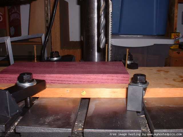

Congrats on the new lathe and thanks for sharing your carriage build with us.
When I made the wheels for my current build, a Naval 24 pounder, I faced off a short length of hardwood dowel in the lathe then glued my wheel blank to the dowel. I could then face, turn the O.D, center, rough drill and bore the I.D. in one chucking insuring squareness and concentricity, then cutoff to final length. I made brass bushing for my wheels and after epoxying in place I faced a few thousands off the front for a clean finish. Carriage and wheels are made from Jatoba, very hard and machines well. Going to make brass axles with a c'bore for a Jatoba
insert. The machining on the carriage was done on my small mill.
  Joe

The wheels I made for my 24 pounder carriage were laminated in two layers to lessen the probability of splitting.  I also milled out the axles for a piece of 1" steel tubing so I would eliminate the possibility of the wood axles breaking.  I plugged the ends of the tubing with wood plugs of the same type of wood and epoxied them in place.  You have to do them one end at a time because the epoxy will trap air in the tube and make the second one want to slide back out (I suppose you could drill a tiny hole in the tube somewhere invisible to let the air out.)
The barrel has been painted black and the wheel pins made and installed since this picture was taken.  And it was fired at the Montana Cannon Shoot.

I would definitely notch the carriage cheeks.  When I did mine I milled the axle beams about a 1/16" deep leaving about 3/32" full height at the ends to lock into the carriage cheeks.
Joe

It's Jatoba, very hard, heavy and machines beautifully. A friend gave me a slab awhile back and I had it identified by a few local cabinet shops as Jatoba.
I resawed it on my bandsaw and had a devil of a time trying to plane it without tearout as it has some wild grain. I succeded by wetting it first then taking light cuts at an angle through my planer. I'll start a thread of my current build in a day or two.
Regards
  Joe
