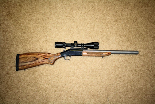

Here is a picture of the rifle - but with H&R laminated stocks
