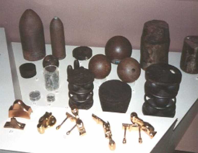

Gary I went back thsi morning to take pictures of the Stove for you...it is not on display, sorry.
These pictures were taken in the museum.
Here are the sights for the 42 PDR.
Listed among the artifacts found on board the  Cairo were these sighting tubes.  I had to shoo through the plexiglas to get teh end details, my apologies for the poor quality.
Some lock recovered in the wreck.
A 42 PDR shell.

DD,
Those are welcome close-up photos of the dispart sight, its protective cover, and the gun locks (I've got them saved for future reference already, Thanks).
Now, as for those wonderful sighting tubes; did you record anything that might have been on the ID cards describing them in any further detail?

Not much detail on the ID card,  But  Elizabeth Hoxie  Joyner's book The U.S. S. Cairo identifies them as  them as Direct Sighting bar.
Catalog number VICKC-1468
"A long hollow brass tube mounted on a long 4 sided wooden base. A brass tab at each end of tube has a screw through it to attachj tube to base. Also a brass strap is mounted over tube at center and screws down on each side. Tube has no markings on it. Wood is black, very hard. Tube is mounted on top. Top is narrow and flat. Side slanted. Three horizontal slots near bottom of base. Wider end has '32/226" cut into the wood. Opposite end has a pin sticking out.  Bottom is slightly concave.  Metal pin near one end. Measuring: Length of base: 26 3/4" (679mm): width of base; 1 5/8" (41.3)mm)-1 15/16" (33.3); length of tube: 22 1/2" (572mm) not excluding tabs.  In complete but fair condition."
Catalog number VICKC-1469
"A long hollow brass tube mounted on a long 4 sided wooden base. A brass tab at each end of tube has a screw through it to attachj tube to base. Also a brass strap is mounted over tube at center and screws down on each side. Tube has two faint rings in brass at one end. Wood is black, very hard. Tube is mounted on top. Top is narrow and flat. Side slanted. Three horizontal slots near bottom of base. Wider end has '32/230" cut into the wood. Opposite end has a pin sticking out.  Bottom is slightly concave.  Metal pin near one end. Measuring: Length of base: 26 13/16" (681mm): width of base; 1 1/2" (38.1)mm)-1 7/8" (47.6); length of tube: 22 1/2" (572mm) not including tabs.  In complete but fair condition."
Coincidentally the tube markings have a similar format to the markings on these trunnion of the 32 PDRs on board.  They are all marked 32/1845...draw you own conclusions.
