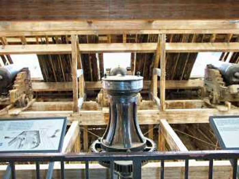

Hi guys, I am Smokinbeaver, Brokenpole's wife that took the pictures on the Cairo. Some of the cannons had the "elevation screw" to raise and lower the back of the cannon, and some had a wooden wedge like block there with no screw. I was wondering what that was for, but guess it was to hold the barrel in place. It shows in some of the pictures of the cannon taken from the inside of the ship. Just wondered if it was there because the screw was missing. Those carriages were not origional as you can tell.

Sharon, according to the National Park Service document, the larger carriages that were used to mount the three 42 pounder rifled conversions, and the three 8-inch smoothbores, had elevating screws, and the smaller carriages were equipped with quoins to elevate their barrels. Both carriages appear to be of the same design, the only differences being their sizes, and means of elevating the barrels.

     Sharon,   We realy love your photos of this ship; they let the air out of certain pronouncements, like ours which claimed a gun was missing and others like the one I just read recently that had all the large gun carriages for the Army 42 pdr. conversion rifles AND the Navy, 8" chambered cannon of 63 cwt. were equipped with the elevation screw and capstan wheel.  Your picture No. 25 shows all the 42 pdrs, yet only one, the port bow gun, has an elevation screw.  The other two 42 pdrs, the starboard bow gun and the starboard No. 1 broadside gun, the pattern 1831 gun with the breaching ring above the cascable, both clearly have wooden quoins for elevation.  Also the large Navy smoothbore in the center bow position has a quoin for elevation.  Don't you just love great pics like these?  Who is going to explain these contradictions to Sharon?  We can't.

Sharon,
Your picture helped solve some riddles that have puzzled us for some time.  The Screw Elevator and the key chain pictures were the most helpful for me.  You confirmed the screw elevator carriage did exist, something that I have never been able to to confirm before.
All of use learned a great deal about this ship and these guns  this past week and your pictures were critical to our learning process.
The wedges are called quoins and sounds  like coin with a "Q".  The were used to adjust elevation of the barrel. The screw elevator at the time was more common on Army Field carriages.

What you have described are two methods of raising and lowering the breech of the cannon to adjust for range.
One is expensive to machine but very precise, the other is cheap to make but more difficult to adjust.

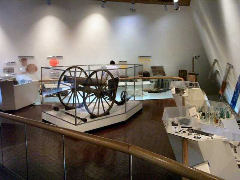

The photo (not very high quality) posted below is of a display of artifacts shown in the indoor Cairo Museum; the display contains ammunition, U.S. Navy "slap hammer" type gun locks, and in the left foreground, two sight blades that were recovered from the Cairo. I have never seen that type of large heavy blade sight before (behind the sight in the foreground), and I can't make out any holes drilled for attaching it to the tube.

This is a photo of the two original carriages that mounted the M1845 42-PDR's (the middle, 8-inch gun's quoin is blocked by the capstan).
Sharon's pic (I cropped it) that shows the starboard stern 32-PDR, and its carriage with an elevation screw (if you save the pic, and zoom in on the carriage, you can " kinda " make out the screw).

Now I have no idea whether this was the gun on the field carrage that was on Cario or not.  I don't even know if it's a howitzer.  I don't even know how to spell howitzer!!!   ;D
But this is a pic a little closer up of the gun in the museum.  I may go up there tomorrow and see if I can get some more information if anyone is interested.
Brokenpole, that's a lot better than the pic I glommed off the net, thanks for posting it. What do you mean, you don't know how to spell howitzer? You already did, twice. :D
Elizabeth Joyner has already stated that the gun in the photo is not the boat howitzer that was originally part of the armament of the Cairo.
Here is the response I got from Ms Joyner on the subject of the missing 42  PDRthis morning.
I'm not aware of another 42-PDR. The only gun that was not found with Cairo was the 12-PDR Boat Howitzer which had been removed prior to her sinking. It had been positioned on the hurricane deck. We don't know what happened to that gun after it was removed.
I may have found the source of the confusion over the model 1841 gun. In looking over material to mail to you, I found a statistical error on one of the bulletins listing one of the 42-PDR's as an 1841 model. As you saw in the information sent yesterday, two of the guns were manufactured in 1856 and one in 1837.
When you and your wife were on the Cairo, you were both viewing (and taking fine photos) of the real deal. All thirteen of the cannon barrels that you saw were the entire armament of the "hard-luck" Cairo when she went down, and they were all raised along with the thirteen four-truck naval carriages that they were originally mounted on.
I myself am interested in all cannons to some degree, and to most things that relate to artillery. The boat howitzers we're discussing were designed by John Adolphus Dahlgren, the first model was produced in 1849, and they were officially adopted by the U.S. Navy in 1850, and were kept in active service until near the end of the nineteenth century, which is in itself a testament to the brilliance of Dahlgren's design.
