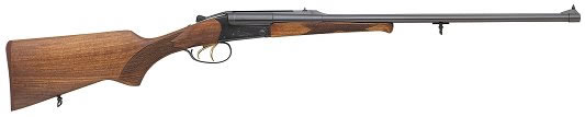

I saw this awhile back, saved it because it was cool...
http://www.connecticutshotgun.com/csmc/index/RBL/rblpro/Professional_flat1.jpg
