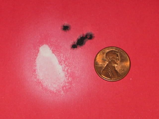

Once I have found my load, I do all my sight corrections with a file, both windage and elevation, or with bullet weight and powder selection.
However, I just bought this revolver used at a local gun shop.  The original owner couldn't get it to shoot to point of aim, so he had a taller front sight dovetailed in.  Don't know why he sold it.  It's a freaking shooter!  Off hand at 25 yards, I turned in a 2.75 inch group and one rested that measured a little under 2".
Of course, the group was 6" low and 5" to the left, but that's not a problem.  Once I work up my load, I tap the front sight over a tad to the left and file down the front sight.
Dan

Flash, there is no such thing as a handgun with sights that cannot be adjusted.  Even "fixed" sights have the potential to be adjusted to a particular load.  As for being "worthless," firearms history would suggest that opinion to be baseless.
People, being creatures of habit, seldom deviate from that which works for them.  Even avid reloaders, once they have discovered a sweet load, are loathe to explore another that will require they make adjustments to their preferred settings.  I'd bet - if you were to query many avid handgunners - you'd find significantly more who have settled on a particular load for a given application and hardly ever try something new with that particular weapon.
I had a Colt SAA in .45 Colt that would strike a 6" plate at 80 yards every time I pulled the trigger on that target.  The load - using Unique and a 250 grain cast lead bullet - chronoed at 900fps from a 4 5/8 inch barrel.  Why would I deviate from that load, for any reason?  What could I hope to accomplish with that weapon, that couldn't be done with that load?
These groups were fired with two different brands of .22lr ammo in a Ruger Single Six that has "fixed" but a drift adjustable rear sight.  Either group would be perfect for squirrel or rabbit after I drift the rear sight.  Why do I need anything else?  I'd bet that I could pick up nearly any box of standard velocity .22lr ammo and be able to make it hit to POA with a few moments at the bench and a brass drift punch.
Both of these squirrels were head shot at about 10 yards with this Bearcat which shoots its ammo to POA.  I'd suggest that they wouldn't claim my gun to be worthless.
This squirrel was taken with a headshot from 10 steps with a .36 Navy cap and ball revolver that has only a bead front sight and a notch carved in the hammer nose.  It shoots to POA - after I did a little tweaking.  How much better could it be?
It's all relative.
Dan
