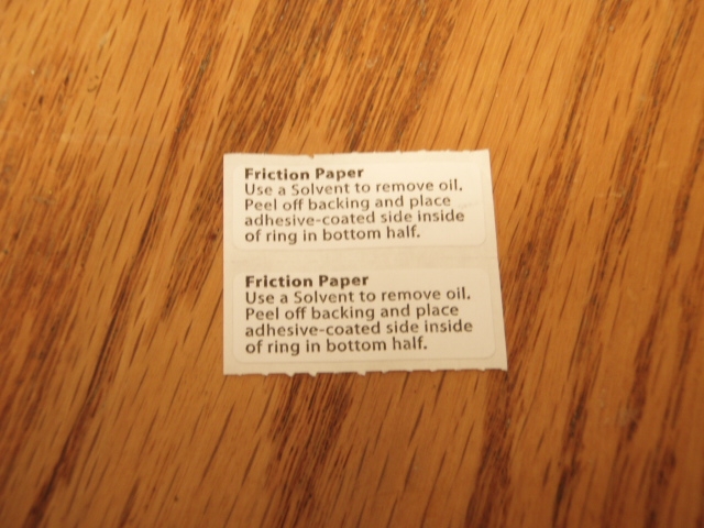

I bought some Burris rings a while back and they came with four pieces of double sided tape to install in the upper and lower ring sections.  You might try that with the Weaver rings.
-WH-
Re: 35 whelen at the range
« Reply #14 on: January 14, 2008, 11:06:47 AM »
Burris friction paper is just like an address label, not double stick tho, only is installed in the bottom ring. Using address labels is in the FAQs as one of the methods of mounting scopes in rings to help prevent rings marks, kind of a poor man's alternative to lapping which is also covered in the FAQs. ;)
