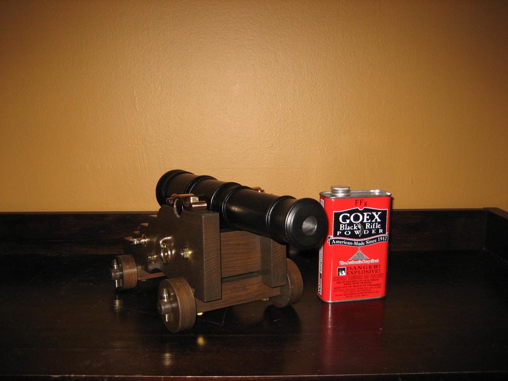

Hey Tropico, Here's a a nice walnut carriage for those Guns... mounted is a 15" barrel  3/4" bore.

EL Cazador 66  thats a smoothie !  .....,yea.., these will make plenty of noise. Rickk  I could fire projos off our beach I suppose..., but these are for our Scuba boat.  I hate to get caught firing projos over there from my ship. Piracy is frowned upon  *Grininng*   ;D  these will be for blanks mostly .  I will build a carriage similar to these at http://www.wildimports.com/44mm_british_naval_cannon.htm wild imports.   this is pretty close to our size cannon and carriage for the boat  and if need be I can fire GRAPES !!!!  ;D  you see if we sink people we cant get the prize      ;D  I figure 1.5 bore with a baby sock full of 38 caliber balls on little broadside of 3 is enough to get me into trouble.  You know how hard it is to hit a target with a cannon........., try it bobbing in the water.  :o
