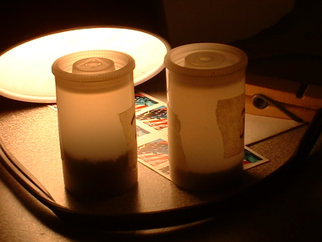

Here are a couple of scaled powder charges in Fugi? 35mm film cans. On the left is 200 grs of cannon grade and on the right is 100 grs of 3f. The film cans are 1.250 outside diameter and 2 inches tall so you can see you don't really need that big of a powder chamber. Of course a baggie and aluminum foil will add to it.
