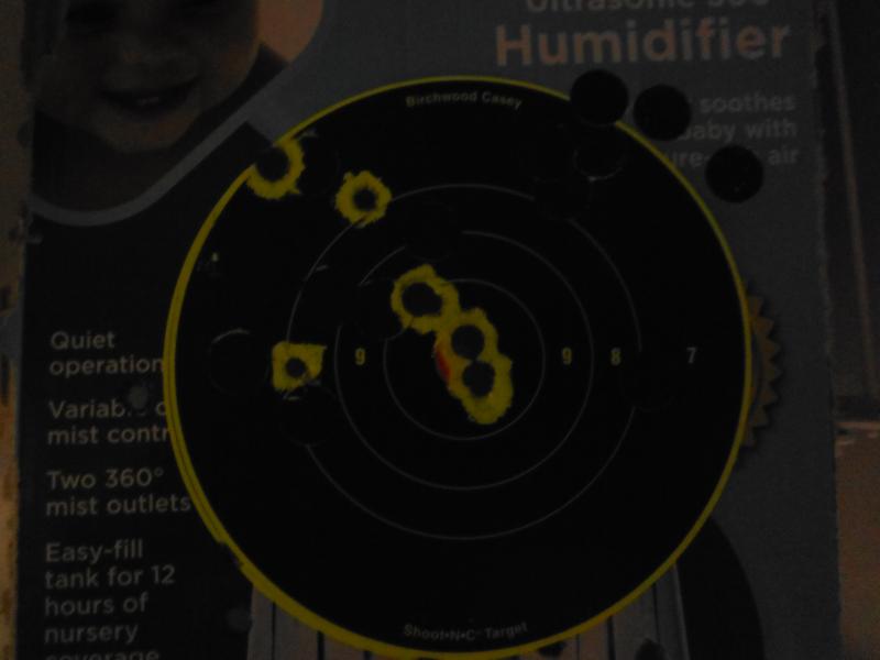

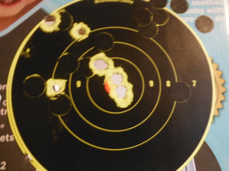

Back off on the power ring a little, IE: 8.5x instead of 9x or 3.5x instead of 3x, I've read that on some scopes leaving the power ring adjustment at the end of travel can lock windage and elevation, worth a try.  ;)
Thanks Tim, I'll try that and post my results. I definitely had it locked on 9 power.

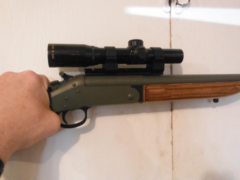

As previously reported, I think my rifle's problem is not the rifle at all. I changed to a Burris Mini 4X and got outstanding results. I sighted it at 25, 50, and then 100yds. With just a few adjustments of the scope I was able to touch holes at 100yds. This old (1983) scope is lightweight, short and still clear and concise. Problem Solved!

Last two shots at 100yds are touching in the center. I'm done! ;D

If you didn't completely remove the iron sights, I'd drop up to 25 yards, do a 5 shot group and see what you get with the iron sights for a group.  If you get consistency with that you can pretty much be sure you are getting some issue with your scope.  I am trying out the Ironsighter 1 piece see through base this week on my superlite .223.  Looks like a nice solid base and lets me still see the irons for close in shots.  ;)

My irons have been gone for a while now. I had the coater fill the slot and holes before he coated it.
