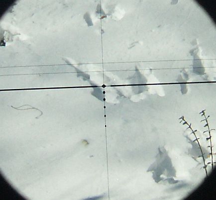

An exception to my maximum 2.5 to 3.0 inches higher than line of sight is for my .338-.378. The main crosshairs are zeroed at 300 yards so the maximum rise is about 3.4 inches. That is with a Nosler Accubond bullet at 3,330 fps. The dots below are for 400, 500, 600, 700 and 800 yard points of impact. Premier Reticles modified the Leupold 4.5-14X scope for the range compensating dots according to output from my balistics program. It works real well at long range but the scope must be on 14 power for the reticle to work right.
