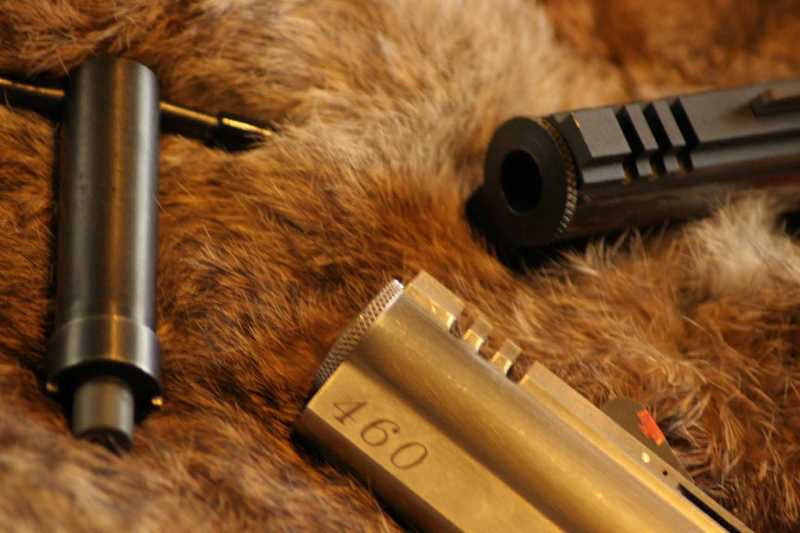

Rolltide I thought since you were pinning this at the top It needed some photos. Here are photos of the factory comp. system.
Dave
