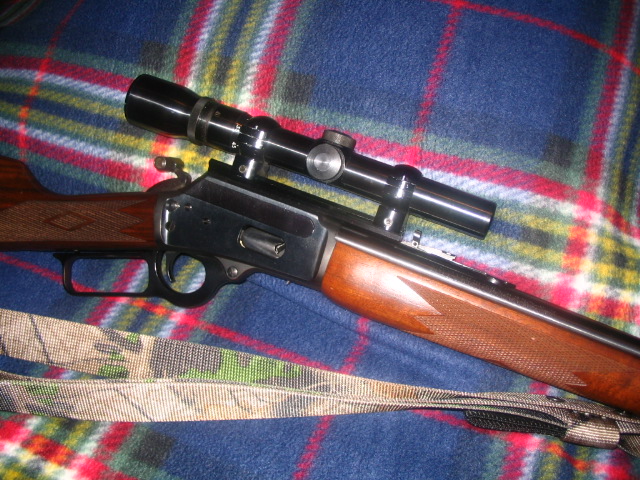

I use Weaver bases and rings.  The scopes I like on lever guns are 20mm tubes, low power variables.  The older Weaver and Redfields are perfect.  The picture is my 1894S with a Weaver V4.5[/img]

« Reply #12 on: June 13, 2006, 12:39:46 PM »
357 Magnum,
Thanks for your photo of your Marlin/Scope combo above............I'd been looking for a neat background for use on my computer........your photo worked and looks great; try it!
