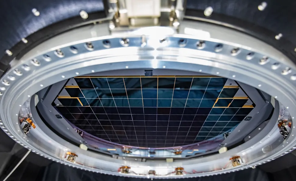

The complete focal plane of the future LSST Camera is more than 2 feet wide and contains 189 individual sensors that will produce 3,200-megapixel images.
(Image: © Jacqueline Orrell/SLAC National Accelerator Laboratory)

Like the imaging sensor in your cellphone camera, the LSST Camera's focal plane converts light emitted or reflected by an object into electrical signals that generate a digital photo. But the LSST Camera's imaging core is far larger, more complex and more capable than any consumer electronic product.
The newly tested focal plane is more than 2 feet (0.6 meters) wide and harbors 189 individual sensors, or charge-coupled devices (CCDs). The CCDs and their associated electronics are housed in 21 separate "rafts," subunits that are about 2 feet tall, weigh about 20 lbs. (9 kilograms) and cost up to $3 million apiece.
The rafts were built at the DOE's Brookhaven National Laboratory in New York and then transported to SLAC. In January 2020, the SLAC team finished slotting the 21 sensor-bearing rafts, plus another four specialty rafts not used for imaging, into their assigned places in the focal-plane grid, an exacting and nerve-wracking process that took about six months.
The rafts are packed incredibly tightly to maximize the focal plane's imaging area; the gap between CCDs on neighboring rafts is less than the width of five human hairs, SLAC officials said. And the sensors are fragile, cracking easily if they touch one another.

Crews at the SLAC National Accelerator Laboratory have taken the first 3,200-megapixel images with the complete focal plane of the LSST Camera, the future “eye” of the Vera C. Rubin Observatory. They are the largest digital images ever taken in a single shot. One of the first objects photographed was a Romanesco broccoli, chosen for its very detailed texture.
"The combination of high stakes and tight tolerances made this project very challenging," SLAC mechanical engineer Hannah Pollek, a member of the sensor-integration team, said in the same statement. "But with a versatile team, we pretty much nailed it."
The newly released images are part of extensive, ongoing tests designed to vet the focal plane, which has not yet been installed on the LSST Camera. That integration step will happen in the next few months, as will the addition of the camera's lenses and other key components, if all goes according to plan.
