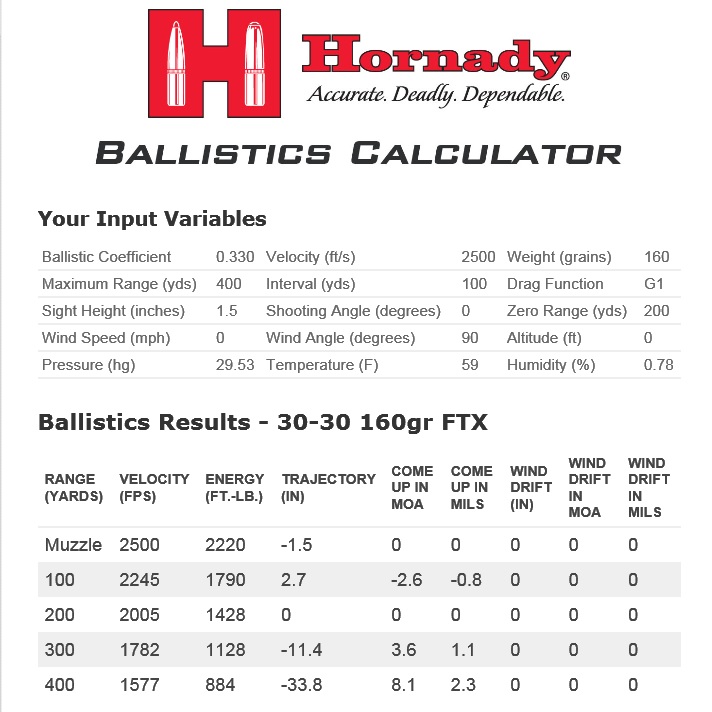

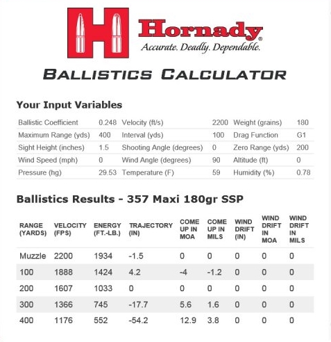

Re: 30-30 or 357 Maximum
« Reply #19 on: February 19, 2014, 01:59:54 AM »
Here's a calculated ballistic comparison of the two.
EDIT: I used the 160gr FTX in the first comparison, I should have used the 150gr Nosler BT as that is the bullet some here are using with LVR powder for the 2500fps value in their Handis, not the 160gr FTX.

« Reply #20 on: February 19, 2014, 02:08:42 AM »
I see the ballistics for the .30-.30, but no .357 maxi.
« Reply #21 on: February 19, 2014, 02:19:12 AM »
I had problems with MHP trying to load the wrong pic, had to restart my PC to fix it!  ???

« Reply #24 on: February 19, 2014, 07:45:19 AM »
Those numbers show a lot but what they don't really show in my opinion is That 180 hitting a deer at 300yards doing over 1300fps Will plow right thru a deer. That is still 200FPS faster than a .357 magnum with a 180 is at the muzzle, I've dropped several deer at 50 to 75 yards with my GP100 and 180 gr cast bullets.  I'ii get the job done just fine, You just need to hold over about 6 inches higher.

Offline RPRNY
  • Trade Count: (11)
  • Posts: 552
« Reply #25 on: February 19, 2014, 08:05:54 AM »
Perhaps, but will you hit vitals given the 16-18" drop from your 200 yard zero?

« Reply #28 on: February 19, 2014, 09:05:34 AM »
I am absolutey certain I can put one in the vitals at 300.  I shoot that far with all my rifles just so I know what they will do.  Kentucky windage works.
