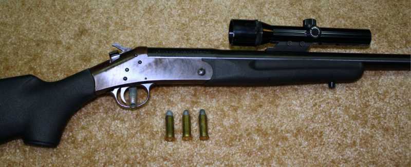

I used the two rear sight mount holes with a T/C mount. I drilled and tapped both of the holes to a #8-32.
Here is a picture of my 44 Mag with a 1.3X pistol scope mounted on it.
Good Luck and Good Shooting
