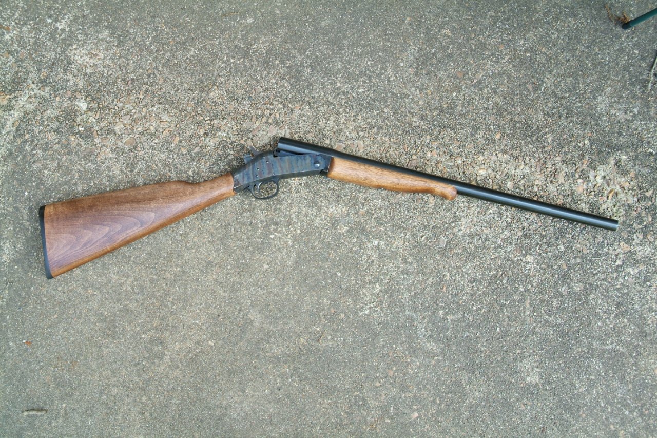

Finally finished my short 20 gauge!
« on: April 23, 2013, 12:23:06 PM »

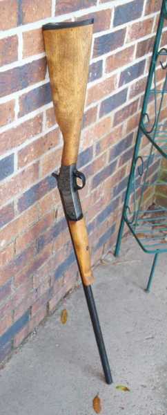

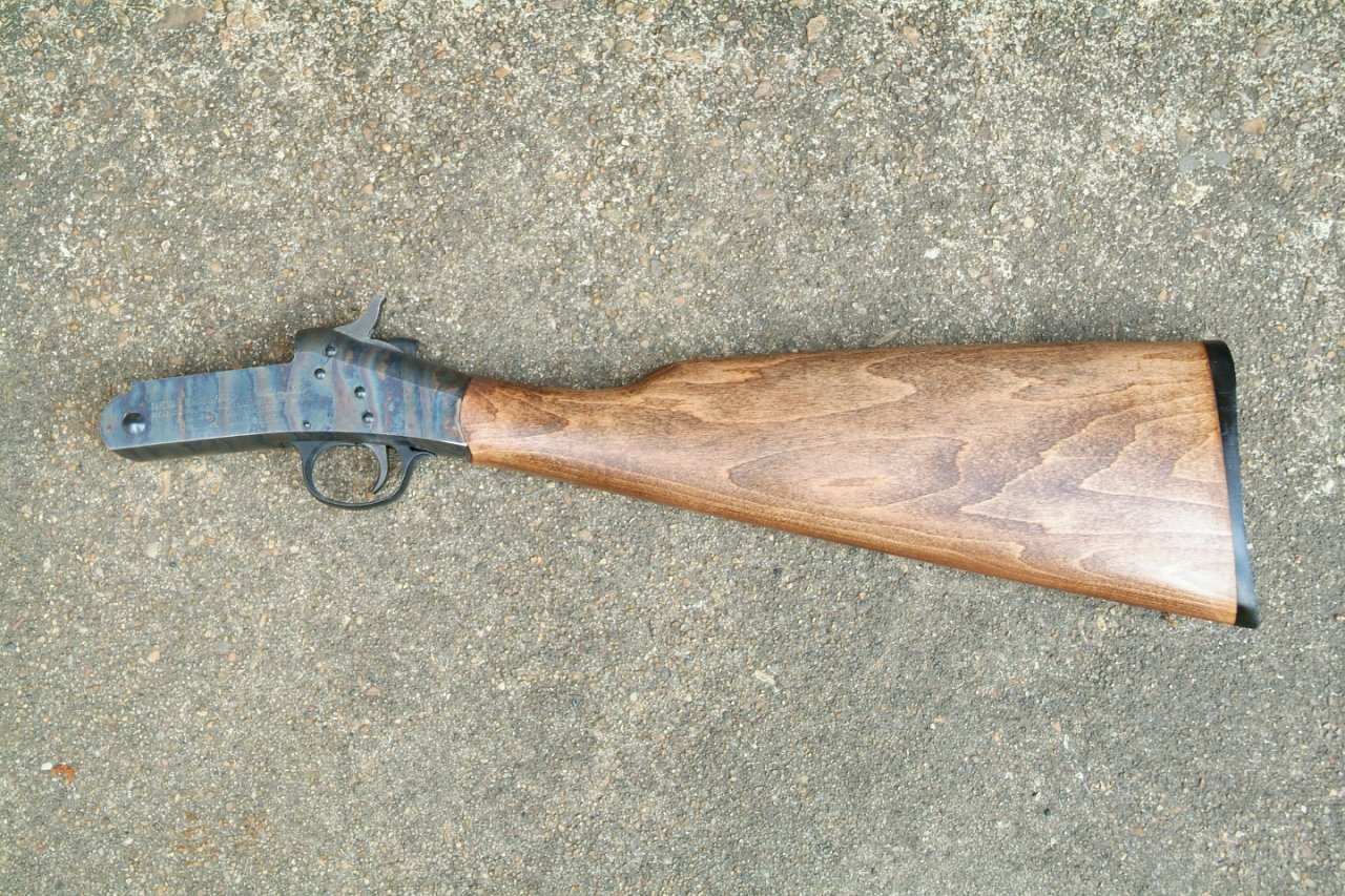

Don't know if I can call it a shorty since it's just a restocked youth 20 gauge with the normal 22" barrel on it.  I was happy with this youth length since even with an adult stock on it it's only 37.5" long, the same as a Winchester 94 carbine, but a good pound and a half lighter.  Bought it at a Pawn shop last year and actually finished with it during the season but didn't like it.  I replaced the youth stocks with adult and started whittling in it.  Cut the pistol grip off and started in with a flat power sander.  When I finished in December the under side of the straight "English" stock looked like a pregnant guppy.  Way too much curve in it for me.  Now that the season is over I had to wait for tax season to end since after I retired I do taxes during that time of year.

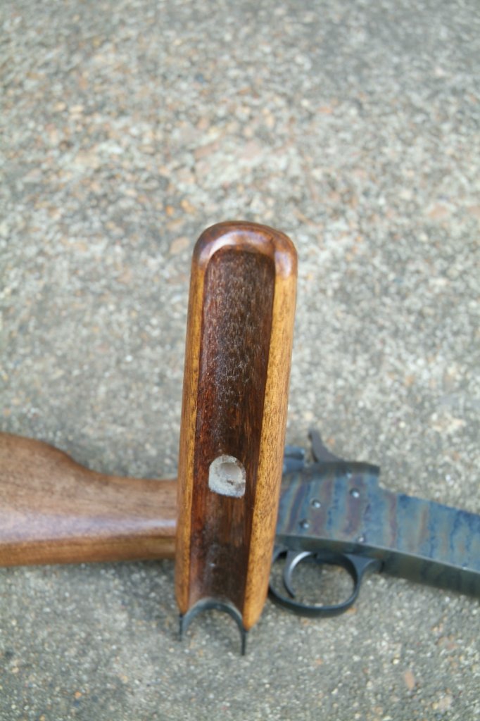

This time I wanted no flat spots on it.  Remington's and Brownings rarely have flat spots which are a sign of sawn lumber without shaping it afterwards.  When I was done the only flat area is where the butt plate fits.  I even rounded the two flat spots on the sides of the forearm where it attaches to the plastic spacer.  You can see the end of the forearm is rounded too.
Pardner wooden stocks are notorious for being boxy and thick and I wanted rounded and trim.  I like it a lot better now.
Here is the whole mess finished.

Nice.  should be a great little carry gun for rabbits and such.  8)

Actually, unless you need to alter the grip area in front of the comb a straight stock is fairly easy.  The only inside corner is in front of the comb.  Simply saw off the pistol grip being carefull not to cut too high.  Then using 60 grit sand paper in a flat power sander shape it the way you like it.  Finish with increasingly finer grit.  Stain and slap on some Linseed oil.  I love the straight "English" style stocks on my shotguns.  My 28" 12 gauge is my favorite though.  The 20 is going to be my carry in the woods gun.

Nice work jp! The grain looks excellent. The 22" length is about as short as I'd want to go anyway, anything shorter gets too loud and the recoil gets worse. I like the rounded off look, too. That should make for a perfect woods gun.

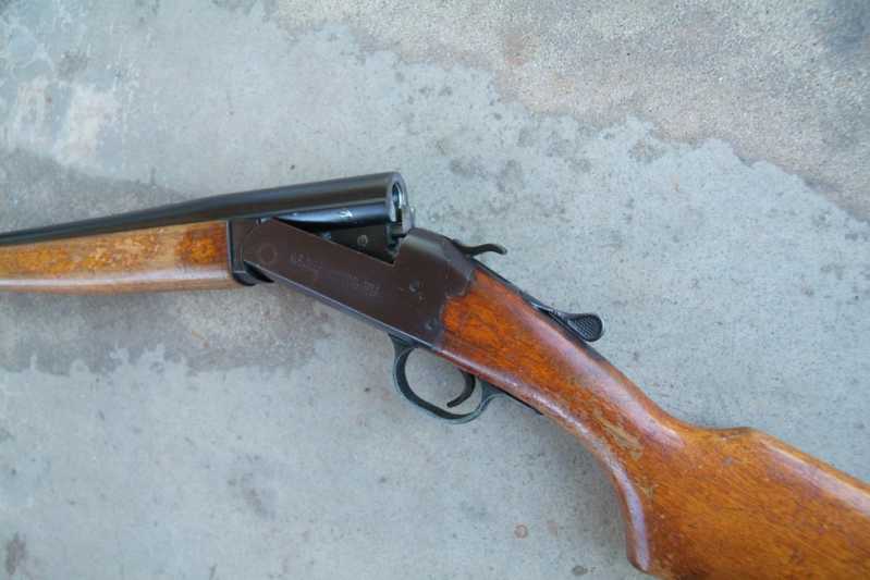

Oh, I'm very pleased with my little 20 gauge after my second time of shaping and it will be carried a lot in the woods.  However, when competition gets real serious with my son on the first day of squirrel season I will be carrying this old veteran.
The wood has more blemeshes then a hormone pumped teenager but I think it gives it character.  Yep it's been shaped to straight too.  It's a 12 gauge 28" (27.5) mod barrel.

That's a mighty fine 12, it looks perfect.
