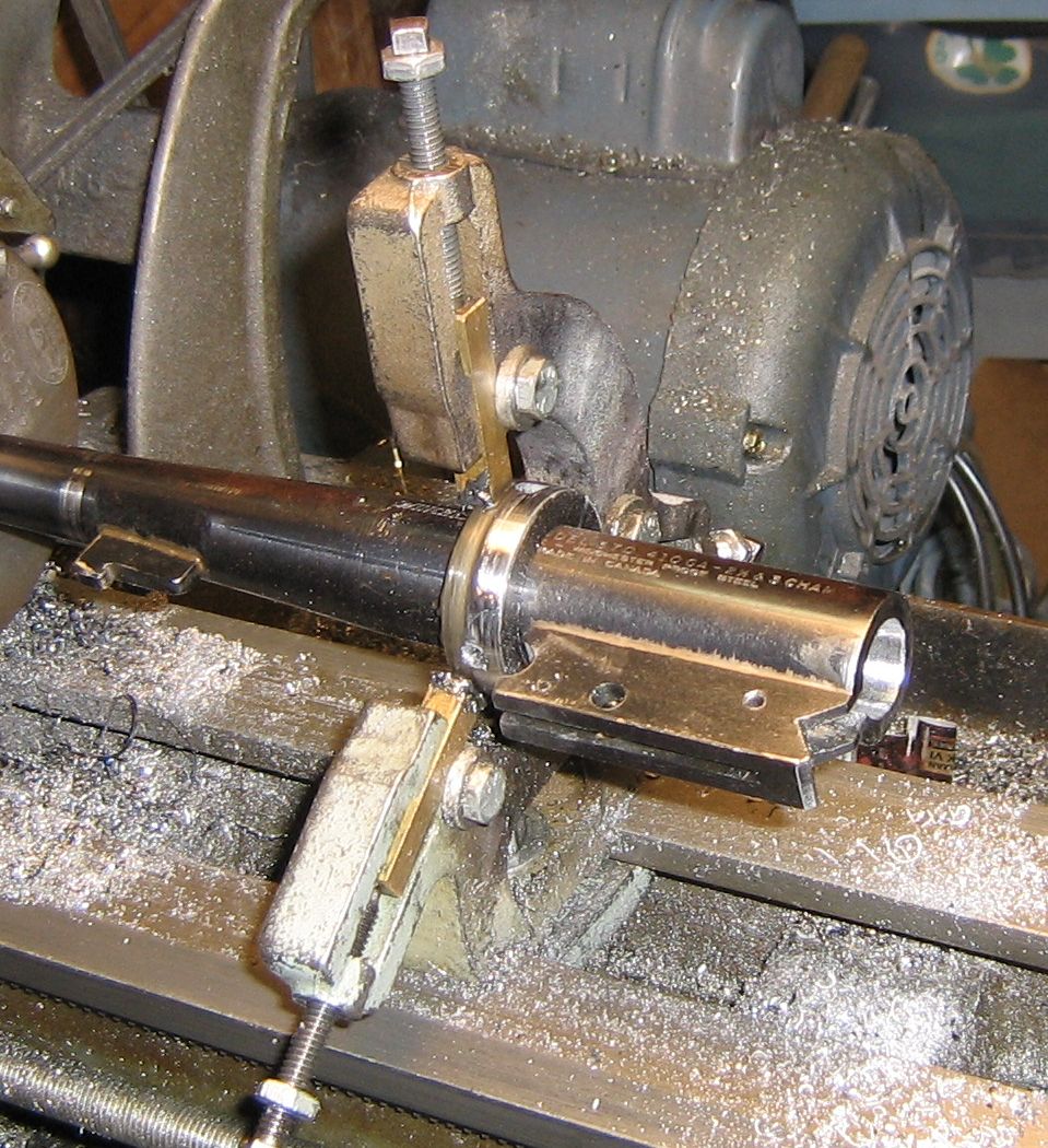

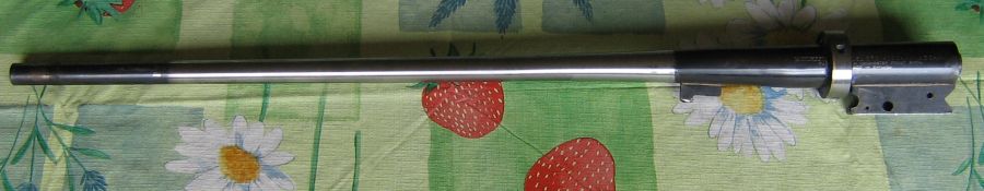

First is a picture of the stub in the lathe with the split collar on it, I bored the center with it closed up tight to .005 smaller than the part of the barrel I clamped it to, then clamped it on and turned it round, worked out well.
This is the barrel assembled, collar still on it because I still need to trim off the breach end and chamber it and need something round to run the steady rest on.  Larry

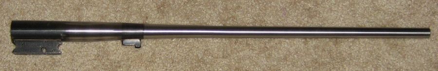

Finished except for the ejector and parkerizing, really want to try this with a H&R, it looks nice.  Larry
