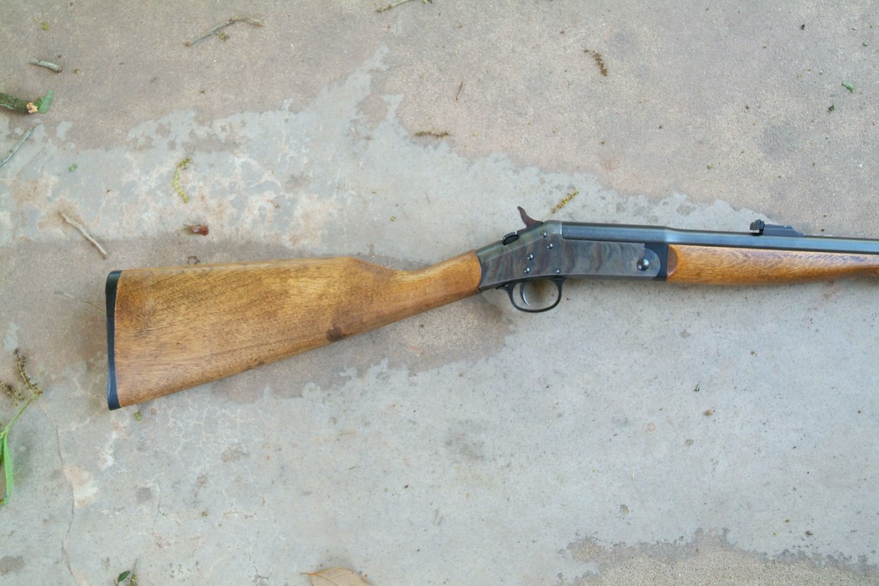

Made a project with that oversized .44 barrel!
« on: April 01, 2013, 08:14:03 AM »
I've had this barrel for awhile and had problems getting a group with a scope.  .432 bore and 1/38" twist had somethng to do with it.  Last year I was checking the pawn shops for a .45-70 when a .444 with the new 1-20" twist showed up.  It came with a 3 - 9 Swift scope already and it was a shooter from the start with Hornady 265 gr Leverevolution ammo.
   Thought I would find a heavy cast bullet load at about 1200 fps to play with.  You noticed that about the turn of the century almost all our old black powder loads were switched to smokeless with a velocity of about 1200.  Sounded like fun but the change of zero I could expect would screw it up for its Hornady load and I wanted iron sights for this load anyway.
   Then I thought that the .44 was totally capable of moving up to 300 grains up to 1200 without even reaching normal pressure.  So I brought out the .44 barrel, removed the 1.5 - 4.5 Scope.  Mounted it on my SB1 frame.  Looks like this now and I like the straight stock on it too.
The older oversized barrel had one good point with the iron sights with screw adjustment instead of loosen, slide and hope.
The newer, loosen slide and hope is here.
I kinda like the new classic look but others may not.  Have some .432 sized 240 grain cast bullets and will try some 300 grain.  If I can get 6 inches with these sights it will be fun to carry around.  Any thoughts appreciated.

Oh, I've heard too many instances where 300 and 300+ grains were shooting good from these 1/38" twist.  Now whether they will do so at moderate velocities I will have to see.  If they do, great.  If they don't I will just stick with my 240 grain.  I'm looking for an "iron sighted" load and certainly not expecting MOA groups from it.
One other change made some time ago, I changed the ejector to extractor by using a Dremel on the "step".  I may be the odd ball but I like extractors on my rifles and ejectors on my shotguns.  So far I haven't spent any money, just rejoined parts left over from prior builds, which to me is the best kind of project to play with.
