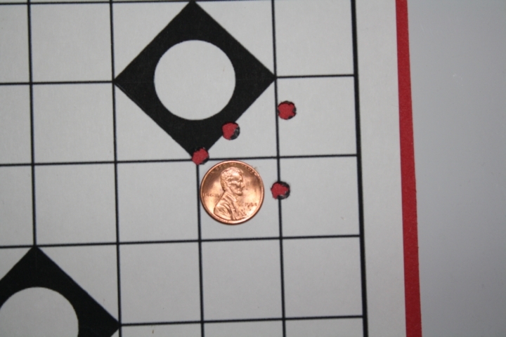

I shot a few groups last Saturday. It was cool and windy, but it let me know the 75 gr BTHP would not key hole. I was a little disappointed at group sizes, but I took it down and the action screws more than likely need a little tweaking. Here is a picture of a 4 shoot group at 200 yards.
As can be seen, the 75 grain bullets are still flying true, even at 200 yards. Like I said, I think I can do beter with some action screw touch-up torquing.

With wind that group aint nothin to sneeze at.  What was that about 1 inch? @200 yds!

The grid is 1" squares, so a touch over 1". I think it can do better, but it is not bad for a "cheap" rifle. It is light too, so it will make a good carrin' rifle.

If that was from the GBO shoot I was there on Saturday and a saw it with my own eyes. There was a swirling wind that day so I imagine, knowing what a good marksman LaOtto is, he can get that goup even tighter. I wish I could do that at 100 yards consistently on a good day.
