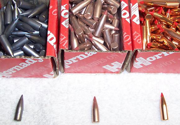

For removing the Moly from the bullets, if you decide you don't like or want them with Moly, the method I used was in the tumbler with old, dirty walnut media (I never throw anything away ;-) ).  After a few hours the media will be black with the Moly it removed. It will also leave a bit of Moly on the inside of the tumbler too.
Below is a photo of some bullets with Moly before and after tumbling compared to new bullets without Moly.
Bill
