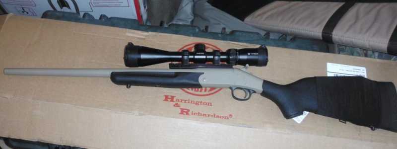

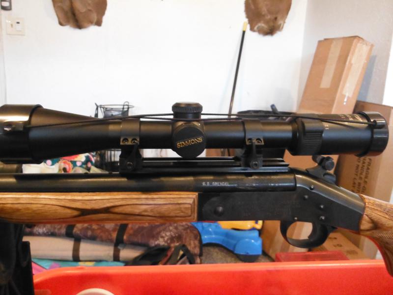

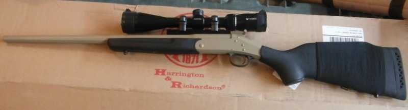

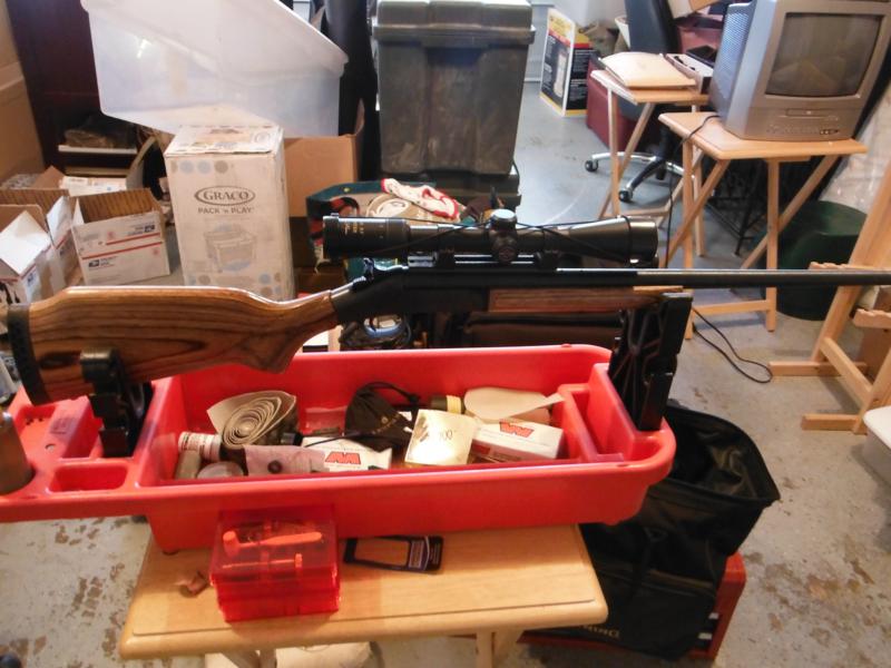

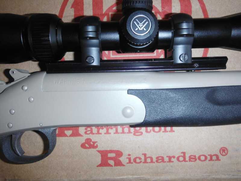

Here's the rifle:

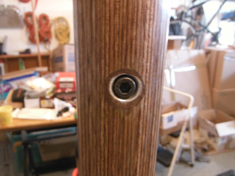

The forend was pillar bedded by Wayne York and although it's terribly sloppy underneath, it works.
It has a 22" 1:9" twist barrel that was originally a .22 Hornet. Wayne York did the rebore. Rifle weight is 8lb 7oz on my postal scale.

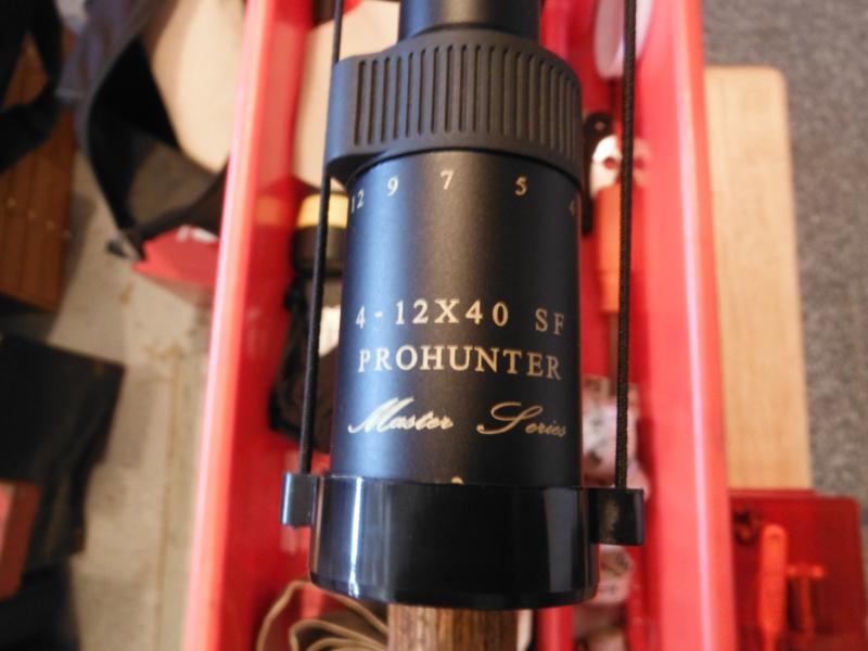

Here's the scope used:
All testing was done on 12 power with the side focus/parallax set for 100yds.

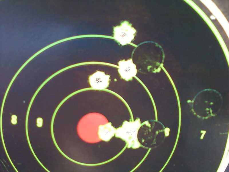

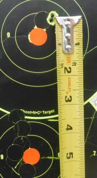

Here's just a few pics of groups. Sorry for the lousy pics, I left the camera at home and had to use my cell phone camera instead. All shooting was done at 100yds.
First up is the 120gr NBT groups. There are two different groups here, I was adjusting my zero.
I settled for the 1" groups about 1" high.

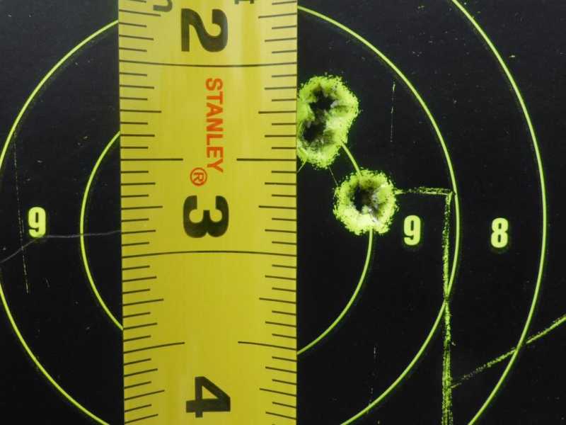

Here's the 90gr TNT group:
Sorry, no pics of the 129gr SST groups. The range was busy and I couldn't find my camera yet. ::)
I also shot my Weatherby Mark V Super Predator Master in .243Win with Hornady Superformance Varmint 58gr V-Maxes. Both rifles weigh about the same. Both rifles seemed to recoil about the same. I was beginning to think that the Grendel was similar in recoil to a .223 Rem. I would need to shoot another Handi to be certain, but the Grendel's recoil was low.
Overall I am extremely pleased with this rifle's potential. Wayne throated the chamber 0.20" longer so that I could seat bullets out farther and gain some case capacity. Considering I was shooting factory ammo set for AR mag lengths, I think this is shooting quite well. After I make some more brass I'll load my own and hope to decrease the group size.

I got out to my new homemade range yesterday and rang out the Grendel a bit more. Since the last range trip it got some new duds; Vortex Crossfire II 4-12x44 with BDC reticle, Burris Signature Series Zee rings, a shortened hammer, extension, a much lighter trigger pull.
All shooting was done at 95 paces. That's all the space I had from the old moldy hay bales (backstop) to the road.
I found that the barrel prefers the 120gr Nosler Ballistic Tips, but shoots the 129gr SSTs just fine.

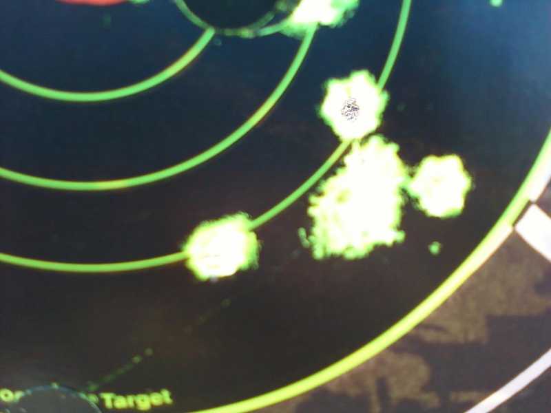

Also, of special note, this barrel shoots much better when it's dirty. Here's a picture of the group following 3 pulls from a 28cal boresnake.
And here's a group after those 5 shots were fired.
129gr Hornady SST group
I always manage to pull a shot from each group. ::)
Now that it's sighted and everything is locked-in I'll carry it with me when I check my trail cameras and bait buckets. ;)

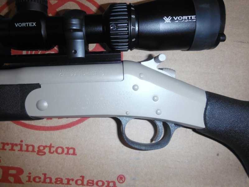

I shot the Grendel Handi today after making a few changes. I Duracoated it, replaced the scope base with an older ultra base, replaced the lam stock set with an old-style synthetic set which I relieved the forend and placed a rubber o-ring in, and lapped the muzzle. I used the bison ballistics calculator to determine an adequate zero. Turns out that with a 200yd zero it is also dead-on at 25yds. However, instead of being 2.3" high at 100yds, I'm 5" high. ??? Everything else checks out near perfect. It shot very well at 100yds with the AA 120gr Nosler BT factory loads. It's a smudge under 3/4".  :) I guess I will need to make my own range/ballistics card based off of shooting at many different distances. I'm also surprised at how low the recoil is. I'm getting closer every time I shoot this rifle to spotting my hits.
