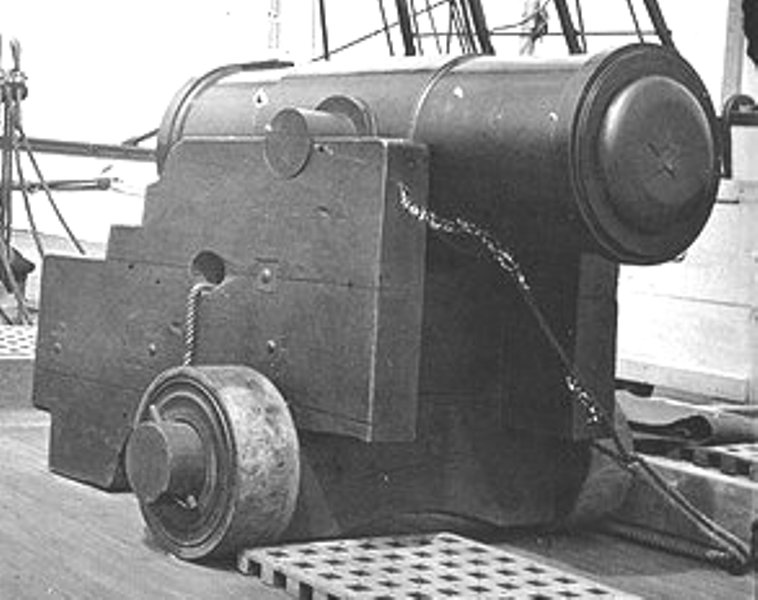

I was thinking I had seen them on a naval carriage like this one...................
Re: A Cannon Discovery Trip
« Reply #48 on: March 02, 2013, 07:23:05 PM »
Well, I'm going to make a leap of faith here, and say that I believe it to be impossible for you to have seen them on a naval carriage like that one; but I do think that it's not only probable, but a certainty that you saw this one 8-inch siege howitzer mounted on this one of a kind marsilly carriage which was made especially for it.

What is it that is hanging on the cascabel?  Are they primer pouches?  Cartridge boxes?
« Reply #57 on: March 09, 2013, 02:13:41 PM »
     Thanks so much Jeff for correctly identifying that 32 Pdr. G.I. Navy Gun of 1823.  Your eyes are certainly better than mine!  Looking at your enlargement, I can clearly see the two lines indicating an astragal and fillets just where you indicated.  Page 150, the one on the left sure looks like it.  Also in the The Big Guns  the authors research reveals that between 1817 and 1828 Bellona, Columbia and West Point foundries produced more that 600 recorded 32-pounder and 200 42-pounder Gradual Increase guns.  The 32 pounder guns weighed, on ave., 60 hundredweight, (6,720 pounds) and were 110 inches nominal length.
     In our travels Mike and I remember seeing two of these, one at Old Fort Jackson near Savannah, Georgia and one at Fort McAllister just south of Savannah.  We covered these forts extremely carefully after discovering Fort Pulaski on Cockspur Island at the mouth of the Savannah River.  It is, by far, our favorite fort and we have visited it 3 times since 2002. Just found a photo of the one at Old Fort Jackson on page 48 in The Big Guns.   In that book it says that the 32-pounder of 60 Hundredweight, Gradual Increase was cast in 1824.  That gun has a ring-knob, two astragals with filets, a raised vent field and small rimbases common on guns of the Gradual Increase style.
Anyway, the Siege Carriage, (Modified Large) is able to carry any of these 32 Pdrs. and it actually did.
« Reply #58 on: March 10, 2013, 08:07:39 AM »
     Sorry, Michael, I didn't see your post when I hit enter on mine.  The best answer in a perfect world would be "Austrian 8mm Ammo in stripper clips Pouch", but since these date back to only 1888, without a time machine, they are out.  You are, of course, correctomundo!  Called a "Primer Pouch" or "Gunner's Tube Pouch", they are carried by the gunner separately from all the equipment in the "Gunner's Haversack" because they are fragile and potentially dangerous if impacted.
Thanks for calling our attention to these, Zulu.
Tracy
« Reply #59 on: March 10, 2013, 08:36:56 AM »
The gun also appears to have a leather vent cover with strap in place.
