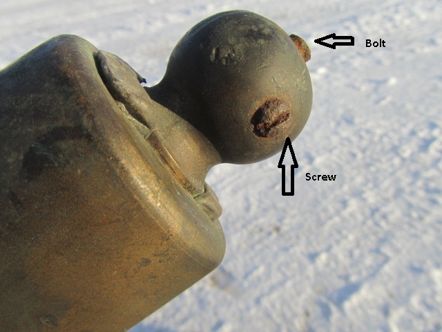

Dewayne I think the  screw/bolt is the elevator on the trail.

« Reply #18 on: February 05, 2013, 01:17:34 PM »
Douglas,
This is the screw/bolt I was refering to.......................

The screw/bolt that Dewayne is referring to is a bit of a head scratcher for me. The "bolt" is more of a tapered plug, not threaded on the visible portions, no screwdriver slot, no bolthead flats and it's on the same horizontal plane as the screw. Because it's mounted dead center the screw can only go as far as the bolt/plug but I can't see it because the bolt/plug blocks the view through the threaded hole. If you look closely at this pic you can just see the bolt/plug where it passes through the threaded opening. It doesn't penetrate the breech face though, so I'm not clear on the why or the what of either the screw or the bolt/plug. The chamber looks to be slightly larger than the bore but I can't tell for what depth. Also, it doesn't appear to be machined, more like it was cast that way but it could just be crud built up. It's hard to tell from trying to stuff my eyeball and a Mag light into a 1" bore.
 This is just an edjumucated guess, but I believe that the large threaded hole was originally for a handle to unlock the breech plug. The "tapered plug" may be where the original firing pin was, which went through a hole in the threaded portion of the handle (inside the cascabel) and then on through the breech face to punch the primer. The screw opposite the handle hole could have been designed to lock the handle from unscrewing (which if it did, would jam the firing pin), or was maybe a stop that engaged a step in the firing to keep it from falling out.
 When things didn't work so well as a breech loader anymore, the owner might have removed the handle (as it wasn't needed on a muzzle loader), hammered a plug into the firing pin hole and filed it flush with the breech face. He then fixed the breech plug in place with lead and drilled the vent.
 Maybe...

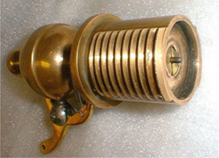

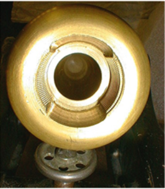

Victor3,
I think your on the right track, I have been able to get a couple pictures from a friend that has a breech that is similar in design to this one, and could be what it looks like inside. They were also made with lugs only (no threads) and held in place with a pin to prevent rotating loose. One thing that concerns me is the threaded hole in the cascabel (my opinion/observation) should be facing the carraige (downward).
Dewayne
Breech Plug
Breech

I've had that style of interupted thread on shotgun shell cannons that I've sold before. But like your photos, they all had a firing pin mechanism which mine lacks. I'll get some more photos of the cascable this afternoon and try to get one down the barrel of the breech, too.
 I'm 90% sure that it originally had one of some sort. No other reason I can see for the extra goodies on the cascabel.
I'm going with 99% sure it did! ;D  I believe (my 2 cents worth) the firing pin was replaced with the hex bolt. I was almost positive I had pictures or a link to another cannon with a similar setup but for the life of me I can't find them :( ..................
