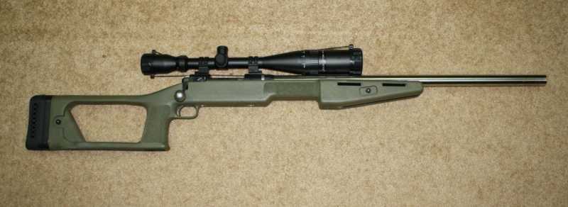

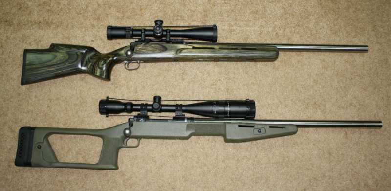

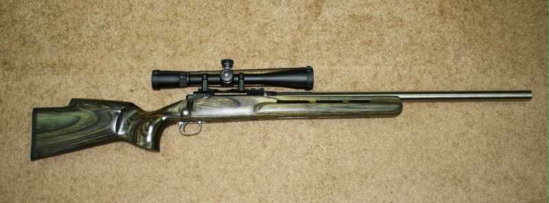

Just got home from the range and wanted to post a couple of targets shot at 200 yards. Both rifles are Stevens 200 with Shilen barrels, custom stocks, after market triggers.
Here is pictures of the rifles

One more picture of the rifles
These were the only two groups shot at 200 yards, the rest were all shot at 100 yards.
I think the groups look pretty good for "cheap" rifles. Even with the barrels, stocks and triggers, they are still cheaper than a Savage model 12 or a top of the line Remington.
I have just gotten a Savage Long Range Target action Left Port, Right Bolt. I have ordered a 222 Remington Brux barrel and Stock through Sharp Shooter Supply. Going to be a couple of more months before I get them into my hands. I will post pictures when I get them. I am like a little kid waiting for my goodies to arrive. It should shoot exceptionally well, but it will cost more than either of these two rifles.
Good Luck and Good Shooting

 Nice shooting ! You say Shilen bbls, but, would you tell me which stock ? which trigger ? I have been thinking about converting a Stevens 200 to a triple deuce also and I could use some suggestions.

The laminated stock came from Boyd's. I do not think they are making them any more. the closest you are going to get is the Thumb Hole model. it is very similar. The other stock is a Choate Ultimate Sniper. Here is a link for one.
http://www.midwayusa.com/product/824713/choate-ultimate-sniper-rifle-stock-savage-10-series-short-action-staggered-feed-with-4275-screw-spacing-blind-magazine-125-barrel-channel-synthetic-olive-drab
It is not a very hansom stock, but it is very heavy and works very well for Bench work and would be good in a PD field. In fact I had that same gun with me When I went to OK on a PD shoot. I was able to tag a few out to 500 yards with it. It is a 223 with 1 - 14" twist. I set it up to shoot 40 grain V Max with.
