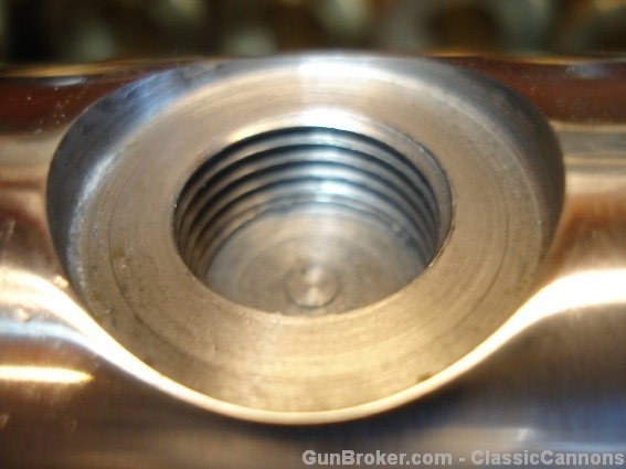

One thing that concerns me is welding on the trunions w/o distorting the close toleranced bore. Any thoughts on that. Obviously it would be better to to do any welding and profiling first.
Having mentioned gain twist Parrott barrels early in this thread, I am now thinking more along the lines of a 1/3 scale 3"wrought iron rifle which had constant twist rifling.
Trunnions need to be welded.  Interference and loctite fit both can come loose.  Been there done that 30 years ago.  Weld your trunnions for safety sake.
When mine were welded they were TIG welded for it lower heat properties as wel as is finer bead.

 Well If the trunnion are threaded and ample collant is applied to the turning od fore the profile it should remain true the trunnios below are tapped 5/8 -18 and then if one wanted they could be loctite'd in how ever i had never had any come loose but they wern't as large as the 1.750 bore just 1" bore
     Classic cannons and PaulB,  we cannot in good faith make any comment about methods of welding and what type to use on your carefully rifled and shaped tube when installing the trunnions.  We are quite sure that welding is the best and safest way to secure trunnions, but we have no personal knowledge or experience to know which type is best and the least likely to cause distortion.  We have several experienced welders on this board. Maybe they will share their thoughts on this related topic.

Trunnion welding.
My Cairo gun is built with 4140.  The trunnions has threaded studs that screw in to the barrel.  The trunnion was machined so when the rim bases were  screwed in they were interference fit.  They had to be screwed in with a barrel wrench.    Several years after the gun was built I attend a shot near Redding, CA.  Since I had never shot there before my gun had to be safety inspected.  The safety inspecter- Doug Titus noticed the trunnions were not welded.  When the barrel was pulled out of the carriage (first time since the gun had been built) both trunnions were found to be loose, and one was bent. One could be fully unscrewed and removed by hand the other would only partially unscrew--I think that was the bent one.
Titus and I also did some test with screwed and pressed in trunnions.  We used a hand sledge and we were able to knock them out and break the screw studs one or two blows.    Doug Titus was no aircraft engineer and just a millwright in a Lumber mill.  In the year I was in the area I learned  tremendous amout about machining from him.
 That's very close (I used 5/8-11 with Loctite) to how I did the trunnions on my 1" cannon in the post above. ~100 shots down the tube and no issues.  :)
