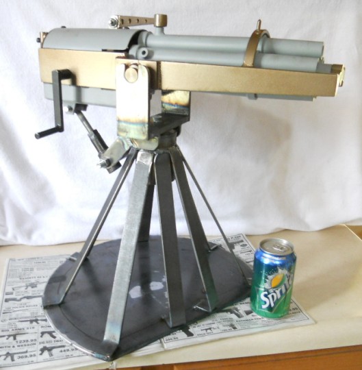

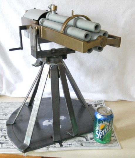

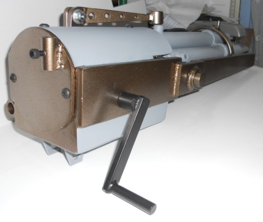

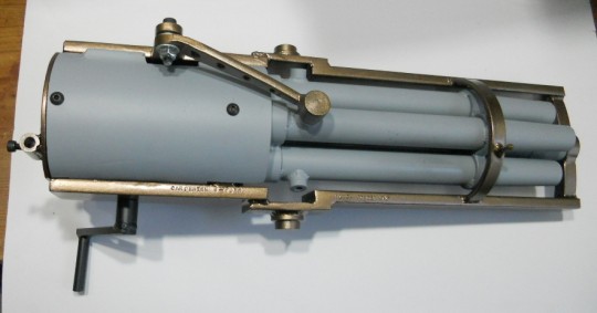

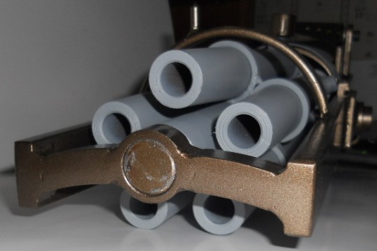

 I started building another Hotchkiss cannon a few months ago and finally completed the barrel assembly.  This is #3 of the rotating barrel cannons I made and is also a muzzleloader.  The 5 barrels are 50 caliber and 10" in length and the overall length of the gun assembly is 17".  It has a worm and pin wheel mechanism that rotates the barrel 1/5th of a turn for each revolution of the crank handle and a rotary sear and hammer mechanism that fires each 22 caliber percussion cap.    I'll make a video soon of the  mechanism functioning and then I'll make a video of it firing when I complete the mount in another week or two.  A naval cage mount with shield for this one.    :)  Dom

Dom, That is really nice work. Great pictures too.

Very very nice.  Can't wait to see it cycle.  Hard to get an idea of scale. Looks monstrous right now.   ;D

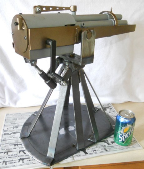

Nice Dom!  I can't wait to see what it looks like on the cage mount.

That is some very talented work. The first photo makes it look a lot larger when fist observed, just beautiful.

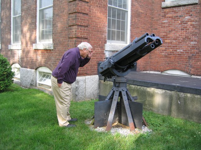

     The next is Mike squinting to see the breech markings on the 47mm Hotchkiss Revolving Cannon located at the north-east corner of  the upper parade ground next to Dewey Hall at Norwich University in Northfield, VT.  You can easily see the size difference between these two.  Mike and I were at Mare Island Shipyard in 2008.  There is a rare 53mm Naval Hotchkiss there.  It might possibly be the only one left in the U.S.  Unfortunately, the official sign next to it is in error.  It has the bore size of the gun, which served on board the USS Thetis, as a 55mm.  According to our copy of 1885 Hotchkiss Revolving Cannon, descriptions and illustrations of the systems, as designed for Naval Service, Field Service and Flank Defence, Firing Tables, Proving Ground Tests and Official Reports by Lieut. Edward W. Very, United States Navy, there were only three sizes made, 37mm, 47mm and 53mm.  Is is interesting that the dia. of the 47mm brass cartridge case, just ahead of the rim measures 55mm.  Could this be the source of the sign's error?  This case is a slightly bottle-necked case, just as the 47mm and the 37mm are.

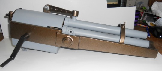

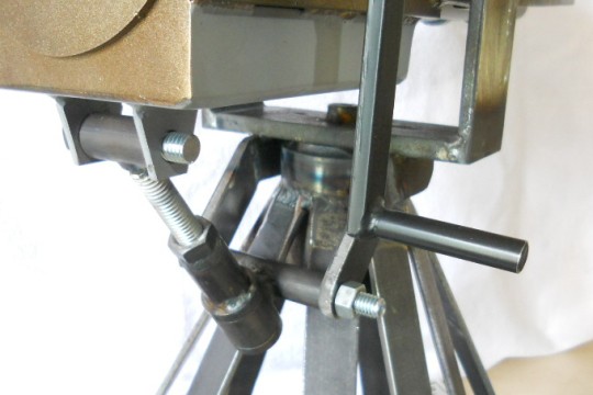

I'm working on the mount and here are a few under construction photos.  I should have the shield on it and completion in about another two weeks.  Dom

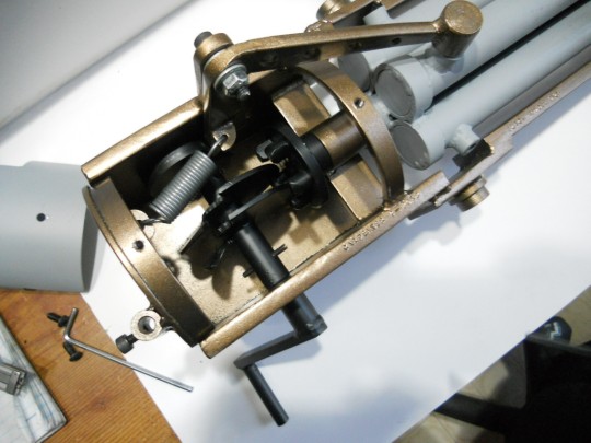

Here's a link to a video illustration of the  mechanism in operation.  The one I built has the same basic barrel rotating and sear set-up.  Since I made it a muzzleloader, I did not need the shell loading and extracting part.  Dom
 http://www.youtube.com/watch?v=GkOP8Lwdmgg
