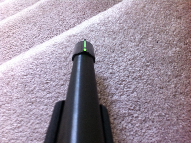

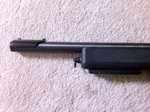

I use a truglo snap on fiber optic front sight on my pardner..........its just a camp gun though, not a turkey gun. It gathers a ton of light though and works great for me.
