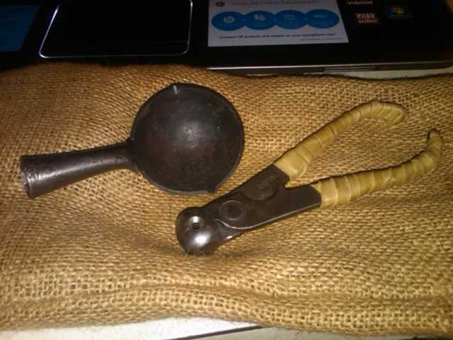

We frequently get somewhat wrapped around the axel about casting thinking we need hundreds of dollars of equipment just to get started; it just isn't so.  Nice to have? Yes!  Improve the quality? Probably.
Besides a campfire (heat source) and some lead all you need is:
