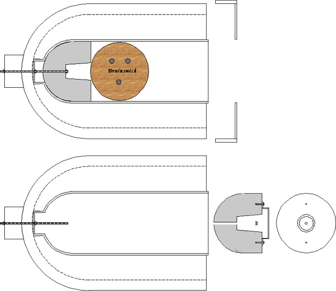

Here's the design for my powder chamber:
Unscrew the nut holding the powder chamber in place and attach the handle to remove from the expansion chamber for cleaning.
Fuse runs through the threaded rod that holds everything together.  No welds to get contaminated.
I just picked up a 3AA2400 bottle today 9.25" dia. as advertised, $351   Painful but worth it!
Construction on the chamber:  going to make a casting of the interior of the bottle and then measure it to see if it's spherical.  If it is then I'll have it CNC milled out of steel.
Comments???
Re: Mortar tube design question
« Reply #22 on: February 29, 2012, 09:22:13 AM »
An interesting design; I assume that through bolt will be pretty large, 3/4" to 1" so the hole will not weaken it much.  I think you should think about something other than fuse for ignition as that is a long hole and could cause the fuse to go out as well as taking a long time for ignition.

Yes, at least 3/4" for the connecting rod.  The bottle is going to have NPT so I can't use it's threads but I plan on drilling those out and fitting the connecting rod to the size I end up selecting.  The length is probably going to be over 8" but won't know until I cut the bottle and see what the profile I'll have to deal with.  The type of fuse I've always used would give a minimum burn of about 30 seconds @ 3 sec/in.  Figured that I'll have to have a pipe cleaner handy to keep the vent clear due to the length.
I hadn't considered electric ignition but had thought about a percussion cap/hammer but all my experience with those are with muzzle loaders and don't know if they'd produce a flame as long as I'd have to have with this design.  I'm about to get into reloading 50bmg rounds, what about a primer from that round?  OH! what if I used a .22 LR blank, or other caliber:  cut down a barrel and could use that for ignition?  I've got a couple of cheapo starter pistols.  It'll be hung off the bottom of the mortar and wouldn't really be seen.  Then I could load it up and have 6 primer shots at a time.  I'd just have to cut threads in the pistol barrel and in the rod to screw them together.  That would be really cool and have a built in safety.

I Under stand what you are trying do.  It seems you are thinking this out pretty good.  But I  am don't know what your thought process is so, I have some questions.
If you have the ability to machine a spherical end on the chamber, why don't do the  mouth of the chamber  spherical also?
I don't like the placement of the vent.  Why are you  not doing the conventional system?
How are you going to attach the trunnions?

« Reply #26 on: February 29, 2012, 04:24:14 PM »
The design of the powder chamber was copied off of something I saw on one of the posts in the forum right down to the conical profile though I had wanted to ask if a cylindrical straight sided chamber would work just as good.  I hadn't thought about making the bottom of the chamber spherical because I hadn't seen it done by others.  I think I got the basic dimensions from a gomer chamber I saw that told me that it needed to have a minimum of 1 caliber thickness all around.
But then I read an article a while back about the handgonne and it showed a very deep powder chamber like a 10x depth to it's caliber and I believe it said that the deeper it was the better the chamber worked.
On the vent placement, that's just the easiest most direct way to get fuse to powder.  The diagrams I've seen on the forum have shown the vent coming in at an angle and that would require drilling into the O2 tank and the powder chamber and would require it to be welded into place and I've read that any weld should be avoided when possible due to the micropores inherent in all welds getting contaminates blasted into them and that there's no way to clean that: end result a corrosion weakness will eventually compromise the tube.
Same deal with the idea of making the powder chamber removable, easy to pull apart to clean and no welds.
I had assumed that the only reason to have the vent come in from the side was that's the "traditional" place to have it for historical purposes and that it really wouldn't matter where it was located and since I already have holes through the base of the O2 tank and I need a connection point right there it was just the natural place to put it.  I'm not overly concerned on making this an exact replica of a civil war mortar.
Also, the stub on the end of the helium tank only appears to be there to have a lift point on each end.  Or perhaps it's there for it to sit in a rack and only be supported at the two ends.  This tank had been used in a lab doing superconductor research and maybe they had it heavily insulated?  In any event after looking at the inside of the tank I see that I can cut that off which would shorten the vent by 2.5".  Looking as my drawings I see that with that stub gone going straight up the back side would be the shortest path to the exterior.
However, I'm all ears to your concerns.  What worries you about this orientation of the vent?
It had also occurred to me that I could set a pair of electrodes in epoxy through the connecting rod and then have a capacitor deliver enough juice to make it jump the exposed gap where they came out in the powder chamber, a sort of home made spark plug.  I'm an old ham radio operator and so I'm all up on spark gaps :)  I'm N5NCV in case there's any op's in the forum.
On the trunnions I'm planning on using the discarded end of the O2 tank to make them.  I'll cut off two sections about 10" long and then cut the profile of the side of the helium tank into one end of the harvested section so that it sits flush.  It's high strength 1/4" steel and should hold the shear force from firing.  Figured I'd do a really deep weld on the inside of the trunnion and then go around with a mig and fill up the seam that will be visible on the exterior and then grind the external welds down with the idea of trying to make it look like the whole assembly was cast rather than welded up.  Then I'll cap the end with plate and weld that on and grind down flush.  If ya'll think this construction method might be weak I could take a piece of 1" x 8.75" flat bar and place it inside the trunnion oriented to be in line with the recoil force to beef it up.
9" trunnions look like the right scale for this size mortar.  Aside from collecting a lot of photo's of carriages I haven't started designing that yet.  I have about a hundred standing dead oak tree's from last summers drought here in Tx and know someone who has a mini saw mill who'll cut whatever sizes of timbers I want but that's about all the thought I've given to what I'm going to mount this on.

I think you should experiment with the spark gap before relying on it.  Black powder conducts electricity fairly well and high voltage sparks like barbeque ignitors will not ignite it.  You would need more like a welding arc.  Also, there is the question of an antique ignition system from the ATF perspective.
I was more thinking about using quills which are really fast and would easily work at the length shown.  You can also start them with fuse if you want a little delay.  A lot of delay is not so good as undesirable things can happen if there is too much time between the lighting of the fuse and the firing of the gun.
