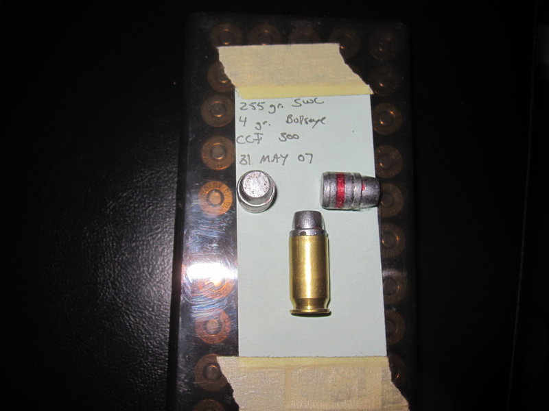

i use a 250 grain semi wadcutter in my kimber that have a big, flat meplat....and it loves them.

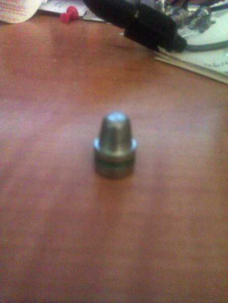

This is the one I'm using:

it turns out that i lied....i use 255 grain slugs...not 250.

I have used the 255gr in several of my 1911s. The bullet I use is similar to the one Myronman3 uses, if not the same bullet. I use Bullseye powder with close to the same charge as well. Shoots really well out of my guns. I have a Tanfoglio that shoots nice groups with this bullet too.

they look the same to me.   i bought mine at a sports store but i would love to have a mold for it.

My bullets came from TVB. Bevel base 255gr LSWC. I am currently using Missouri Bullet Company bullets, so don't know if these are still available.
