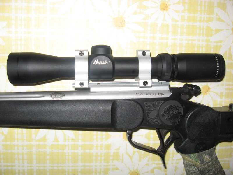

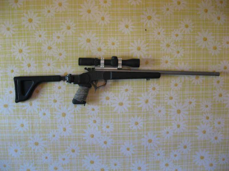

Starting the process! Put together a 30-30AI on a Contender frame, MGM 22" tapered fluted stainless barrel, compact Burris 3-9 scope.
https://www.gboreloaded.com/mhp/images/65Jeffrey/001.jpg
https://www.gboreloaded.com/mhp/images/65Jeffrey/002.jpg
as you can see using the Contender frame allows me to use the tried and true choate folding stock, have a G2 debating using it. Will try both see if there is any accuracy difference.
