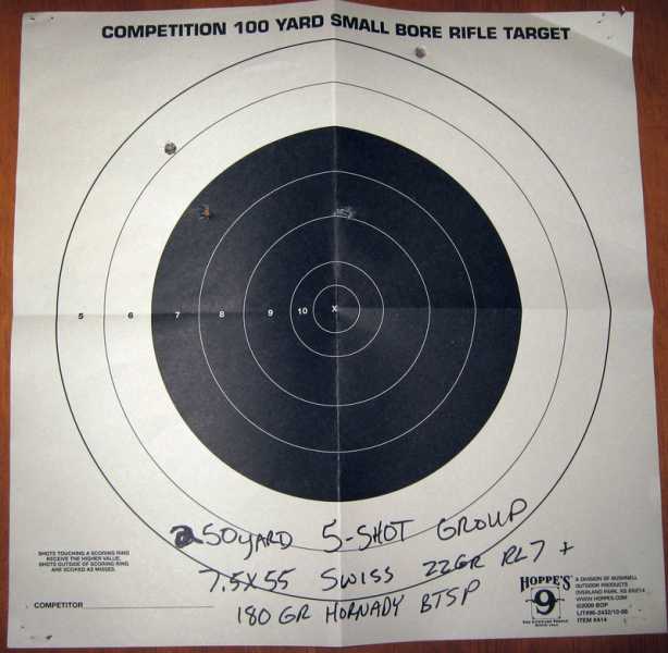

Well shot a couple 250-300 yard groups today with these.  Nice light recoiling load using Reloader7 in a midrange pressure loading.  Getting estimated 1600fps with the 180gr. BTSP.  Here's a pic of my 5-shot group at 250yards with ironsights.  Had one called flier and it just missed the right edge of the paper and clipped the target stand.  Still would have been in kill range.  8)

If you are going to be hunting deer you need more velocity with that bullet to get it to expand. I would try either one of the 150 or 170 gr bullets made for the 30-30 Winchester at those low velocities or go to the 125 gr Nosler ballistic tip and push it around 2500 fps or so. It is a real deer killer bullet.
