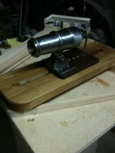

Started the display unit for the carronade today, I selected a 24 inches of 8 inch wide 8/4 white oak that came from a barn that was torn down thirty years ago, after having stood for nearly a hundred. Even after planing, joining and sanding, I won't have to do anything to make this look old....

Day 2 of the display base build, that bottom piece is the 8/4 oak, mortised so I could use a single piece. The part under the carronade itself that slides, is 3/4 walnut. First coat of tong oil completed on both
