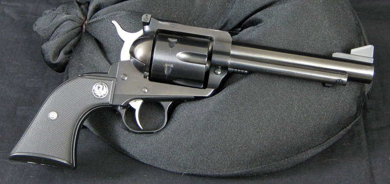

I picked up the Lipsey's .45 convertible Blackhawk today and really like the looks and feel of it. However, the dimensions of the cylinder are quite a bit different from my SAA. The SAA has .455 cylinder throats, so I bought some .454 cast bullets for it. I also have several types of .452 bullets.
The Ruger has .449 throats. I've read that this is common for their guns to have undersized throats and a lot of folks open them up. I want to shoot it first and see how it does as is, but I wanted to ask you guys with more experience with the .45 a question - could there be any danger in shooting the .454 cast bullets in this gun? I just checked and they fit the cylinder ok. I'm just wondering if there could be a pressure problem from squeezing the bullet down that much? These are not super hard - BHN is 15. And my loads are not hot and shoot fine in the SAA. Thanks for any help.

There most likely won't be any pressure problems, if you're shooting sane loads . Accuracy might be another ball game tho

Thanks for the reply, Ranch. I cleaned it this morning and had time to shoot 15 rounds. Started with some 250g .452 XTP bullets and it shot them ok. Took me a few shots to get the sights dialed in, but it put the last 3 into a 2" group. Then I shot a few 200g cast bullets that are sized at .452. It sprayed them everywhere; maybe a 10" group. That load shot pretty good in the SAA, so I am suspecting I'll have to have different ammo for each gun. Lots more time to play with it to find out.

Yup, the lead bullets are squeezing down to .449 then not taking the rifleing.  You will have to either open up the throats yourself (of have your local 'smith) or contact Ruger and ask them to do it.  Hopefully you can just send in your cylinder rather than the whole gun, but if they ask for it, ask them for a call tag so you don't have to pay for the shipping to them.  I have been fortunate for over owning dozens of Rugers I had only one, a SBH .44, that would not chamber .430 cast bullets and had to be opened up.  All have shot very well.  Please let us know what you do and how it comes out.  44 Man

 With the jacketed bullets shooting alright, I'ld do a bit of messing with the cast bullet loads before I got real excited about the gun needing worked on.

Thanks for all the replies. I got to fire off about a dozen shots since I last posted, but haven't really been able to objectively evaluate the accuracy of the gun. I had about 10 rounds loaded with .454 255g cast bullets, and they definitely shot better than the 200g .452 bullets. Part of the reason probably was that the 200g load was a pipsqueak load that I was trying develop as a plinker with my SAA. I'm thinking the bullets squeezed down and there wasn't enough pressure to make them open back up and engage the rifling. The other loads I shot were standard velocity and shot better, though nothing to brag about. I'll have to do more testing before I decide what to do, and that means I gotta find some reloading time as I am all out of ammo.
I was hoping my new gun wouldn't have this problem, but I had read of it happening and figured it would be my luck that it would happen to me. I read this article by Jeff Quinn on how to fix it:
http://www.gunblast.com/Brownells_Reamer.htm
I'd probably be better off to send it to someone instead of spending $100 for the tool, but I'm not real anxious to mail another gun to a gunsmith. I sent my SAA to Long Hunter almost 2 months ago and still don't have it back. Somebody else on here got one back in a week, but my luck with single actions seems to be bad. At least the Single 10 is still working well and seems to be a fine gun.

Do NOT go digging around inside a cylinder with a dowel and emery cloth. You think you have troubles now just wait until you get those cylinder throats shaped like a AA grade medium egg.That sort of thing is best left to folks with the proper machining tools and the ability and knowledge to run them.
 If your gun is getting decent groups with the heavier bullets then take a clue from that and go to work on load developement.
 I don't know how many countless times we've read about the bad cylinder throats on Rugers, yet I don't have a clue on what my nearly 40 year old blackhawk 45 measures, but it will handle bullets both cast and jacketed from .451-456 just fine, as will the new version Vaquero.
 You might want to try a "poor" mans trigger job on your gun and see if a lighter trigger pull doesn't help things along some.
 You haven't said what powder you're using, but if an accurate load with quality bullets can't be found with unique,2400 or bludot, then it may be time to have a professional look at your gun and fix what they find wrong with it, and if it's judged to be a factory defect then by all means ship it back to either Lipseys or Ruger and get it fixed proper.

I would not send it back to Ruger or do the wooden dowel Beartooth Bullets fix.
If you send it back to Ruger, they might replace the cylinder with one that has oversized throats or throats that are still not all the same size.
If it were my gun, I would just assume the throats need opening and send the cylinder to Cylindersmith.com. It will cost around $30 plus shipping and you will have the cylinder back in about a week. At least then, you know the cylinder is right.

I don't have any pin gauges. I just used my caliper, and according to it, each cylinder is between .448 and .449.  I also have an outside mic and a bullet that measures .450 with it will not enter the throats. I realize the caliper is not ideal for taking such a measurement, but there is no doubt that it is undersize. The same caliper says the throats on the Colt are .455.
I too, have read of others getting recent Ruger .45s with properly sized throats and was hoping I'd be lucky. It was the first thing I checked when I got the gun home. Oh well.
