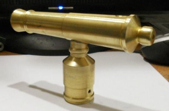

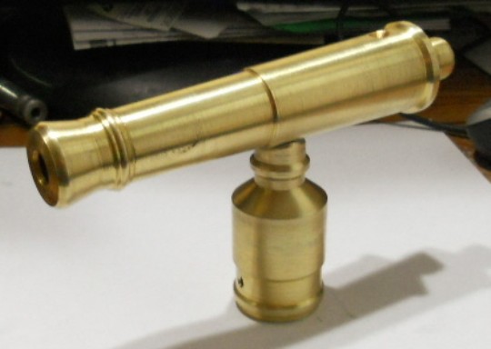

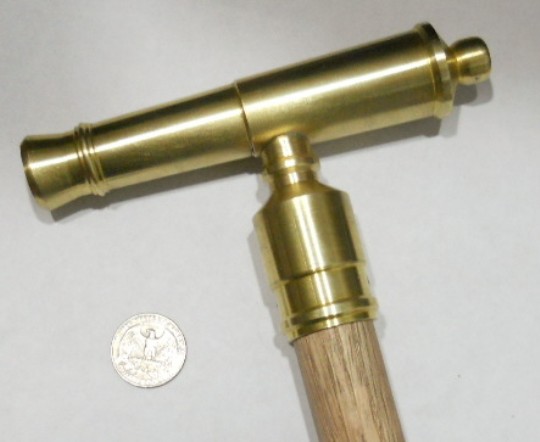

I was sent a chunk of brass a couple months ago to make a cheroot cane.  Here it is.  Photo below.
It is 1-1/4" OD x 6" oal, with a 30 caliber [5/16"] bore.  The socket fits a 1" diameter stick.  I had a blast shooting it today.  I used 15 grains of 3F powder and a .300" round lead ball.   :) :)     Dom

That looks great in brass!  Plus, the smooth lines of it should fit comfortably in hand.  I think the depth of the socket, the wood choice/amount of runout, and the fitment of the wood would be the biggest factors in how much strength it could support.  Other cane heads are attached similarly enough.
This one would use a 1" diameter shaft.   I can get Oak dowel up to 1-1/2" diameter.  that would be a massive cane.  Perhaps a one inch bore?  :o   :o
A 1" bore would be no joke.  You could load it with shot, and it would be highly effective, even with a short bore.   ;D
A 1.5" shaft would work well for a walking stick, though would be a bit on the beefy side for a cane, I think.  ;)
I'd stick with a natural patination.  Bronze/brass will develop it very nicely (polished works best for even results), especially if you wipe it down with a dirty cleaning patch.

Re: My First Brass Barrel Project
« Reply #15 on: August 16, 2011, 12:34:49 PM »
You inspired me, here is one I started today. From my knife making experience I know that a 5" handle is most comfortable for most people. This one is 5 1/8 inches long, 1 5/8 at it's thickest, 1 1/8 at the muzzle, bored and reamed to .50 cal. to 4 1/8" The "trunnion" is half an inch and as soon as I have it affixed I will bore the vent. It will sit nicely on 15/16ths shaft, or as I intend, turning one in the wood lathe and seat it properly.
