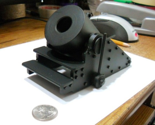

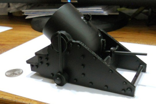

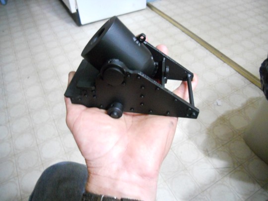

I just finished this.  It is 75 caliber.  The overall length is 5-1/2" and the height is 3-1/2".  Also,  I finally found micro size rivets for steel carriages.

GLS,  looking forward to the video.  The weight is just under 3 lbs.

Awesome job!
Where'd you get the rivets?

I used #6 bright finish nails.  Smooth the nail head with a sander to remove the nail set dimple and they make a nice small rivet.  I countersink the back of the rivet hole and tig weld them in from the back side and sand the plate smooth.  The smallest rivets commercially available are too large for these micros.

GLS,  Nice video, thanks for posting it.  The vent is 5/64"  For fuse I use 1.4mm, 1/16", or 1.8mm.  The 1.8 is a little tight but will work.  Either cannonfuse.com or pyrocreations.com  should have it.
