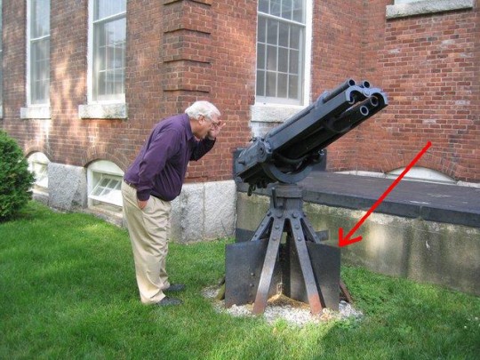

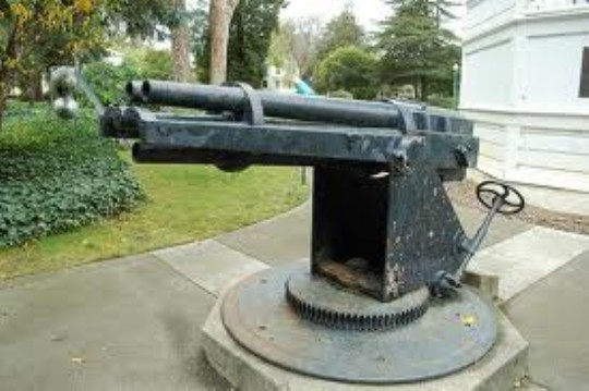

     Fantastic, Dominick, looking really great!  One of my favorites from way, way back.  Now if you were to consider making one on a traditional Naval Cone Mount like the one in the photo below, then you would really have something.
Tracy
When Mike and I visited Norwich University in Northfield, Vermont in 2008 we took a few photos of this  U.S. Navy  47mm Hotchkiss Revolving Cannon  No. 22    Wt 1,268 Lbs    1898
Wow, look at that; the cannon barrels have left hand twist!

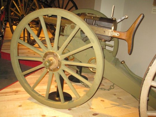

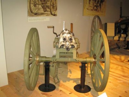

Zulu,  I found  photos of a steel field carriage I like so that is the direction I'm considering.  The 1880's style carriage has a twin steel plate riveted assembly for the trail and a round tube axle.  This field carriage design is a personal favorite. Photos below.  I'm thinking of using 2" x 3/16" flat stock for the side rails and making a pair of [12 spoke] steel wheels.  There were a limited number of steel wheel carriages during this time mainly on light Gatling gun carriages.    I think I need a stable firing platform with a locking type elevation device because the cannon will not have any firing mechanism.  It will have a direct spindle mount rear crank handle and a small mallet to fire each barrel [strike each percussion nipple] as it is rotated to the 12 o'clock position.  This is the K.I.S.S. revolving cannon design.  Keeps the build time down.  :)
M & T,   The cone pedestal is a very interesting design and if I'm correct, it was also used with the Gatling and Nordenfelt guns.  Thanks for the idea and the photo, I didn't think of using this mount but I was earlier considering a similar one that is pictured below.  I'm not sure if this particular one is a display mount or if it was actually used with the Hotchkiss.

M & T,  Do you know what were these plates are for?  Are they part of the original mount?
     They are original equipment, Dom, although I will admit that, at first, I didn't think so.  After a little internet research, I found a photo that shows the very same set-up on a Hotchkiss Revolving Cannon Naval Deck Gun.  Although most of the mounts we have seen these anti-torpedo boat guns on are the solid, sheet steel, cone mounts, this one is skeletonized just like the N.U. Gun.  The square plates are obviously part of this mount's bullet shield. From www.boat-links.com
I think the wheeled carriage you found is nicer looking than this one, but some might like this one, I guess.  From www.thegunzone.com this image is of a British Hotchkiss 37mm crew in German East Africa, date and photographer unknown.
If you are a fan of inexpensive shingle shot firearms that are very handy, you know the ones I mean, you might appreciate a carriage like this one for your Hotchkiss. This one was found near the Verdun Fortress during WWI.  I can say this because I count myself as an owner of one very Handi 12 GA shotgun.  It looks really plain and handles like a tire-iron, but I have a soft spot in my heart for it, because it was the first 12 GA I ever bought.  It won a few turkey shoots in Louisiana for me too!  From www.thegunzone.com

When I was searching for carriage designs, I came across the one in the photo.  It didn't appeal to me either because it looked like a retrofit from a field cannon carriage.  That cone mount looks pretty cool with the shield.  The skeletonized version is easy to make and not very time consuming.

Dom, here is a cone mount that is similar to the one it M&T's picture. Battery Park, Charleston, S. C., 1980

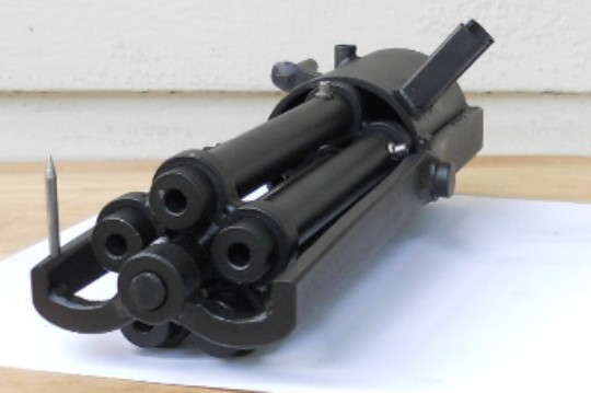

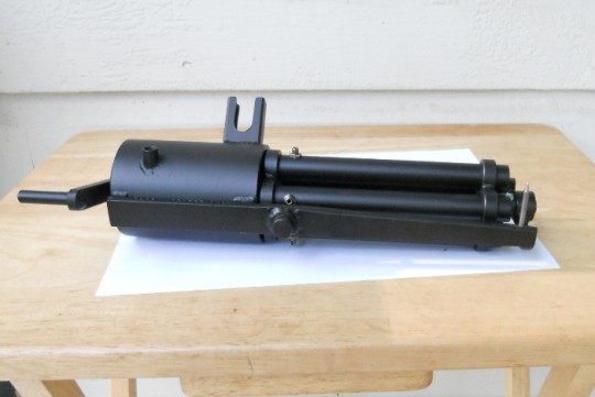

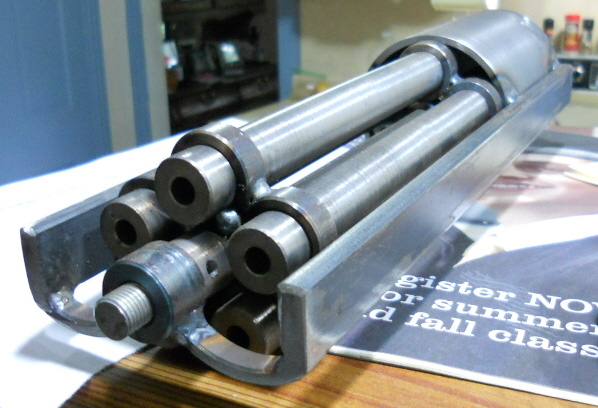

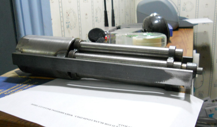

I am going to build both the carriage and skeleton cone mount without shield.  Cone mount first.  I finished the barrel.  I had to shorted the nipples to clear the side frame rails.  They are only 3/16" tall.  I made the front barrel support thicker, tapered the side rails and added rim-based trunnions.

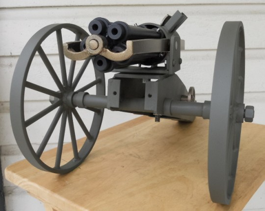

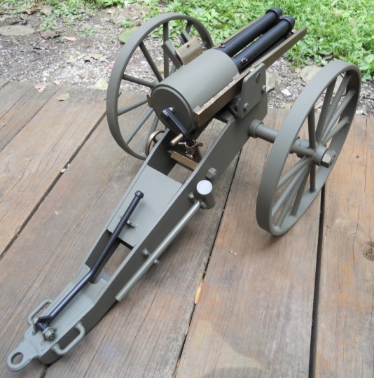

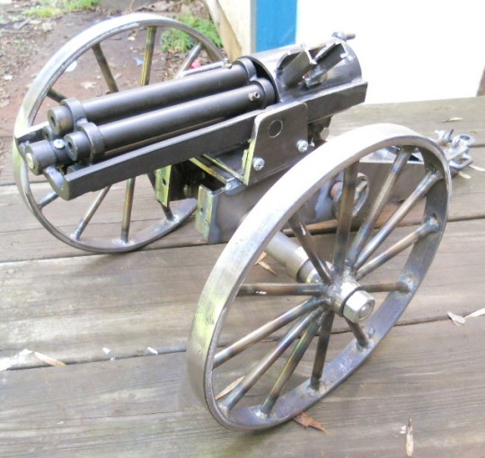

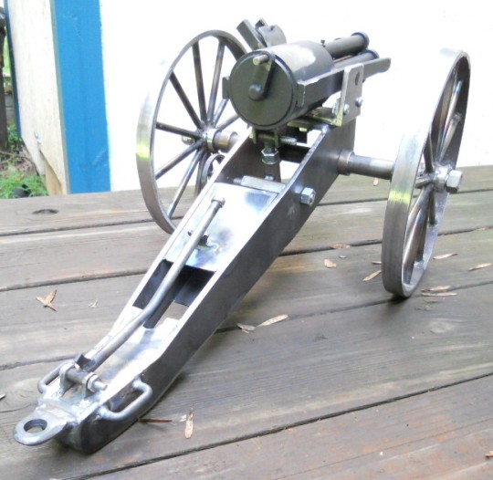

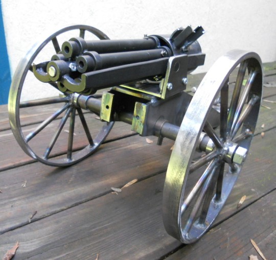

I finished the field carriage for the mini Hotchkiss cannon today and with the hurricane coming I not sure if I'll get paint on it this week.  Here are photos of it without paint.  I still have some minor things to do to it yet.  I will paint the carriage olive drab.

Very neat.  You going to make these an offering in your line?  Personally I'd rather have it on some sort of a swivel or fixed mount.  The carriage is a nice touch but likely an expensive touch and a solid base is more appealing to me.

What did you make those wheels out of?  The whole thing came together nicely!

Mike H.,  The wheels are made from 1/4" x 3/4" rolled flat stock and 5/16" solid round spokes.  Tig welded assembly.  Dom

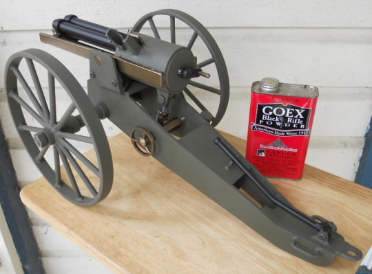

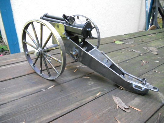

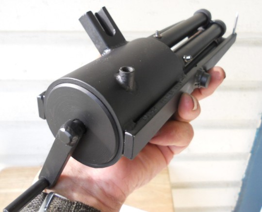

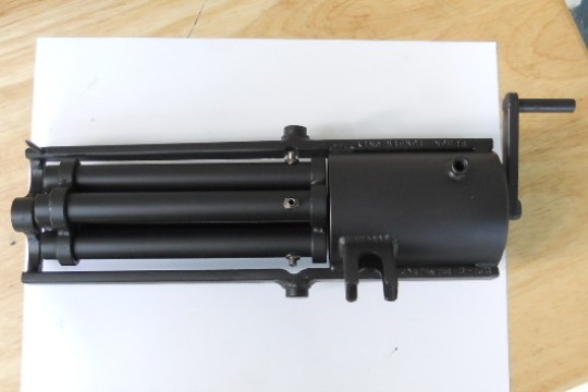

« Reply #29 on: September 01, 2011, 08:40:31 AM »
I finished it.  I went for the multi tone barrel color like the museum piece that it's modeled after.  Ok, I wimped out on the sights and didn't install any.  :P   It appeared that the rear sight would be  sticking up right where the operators hand would be when tapping the mallet on the primer caps. I also appears that the land service Hotchkiss which mounted to the field carriage has side rail mounted sights because of the shield and the sea service [naval] Hotchkiss has the top mount sights.   This is for sale.  I'm asking 500 dollars.  I'll pay the shipping cost.   I'll post a video when I get a chance.   Dom
