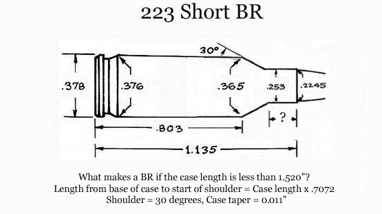

Shane, the 223 Short opened up to 30 cal, would that be 223/300 Whisper?
I am thinking of asking Larry to make my 223 Short chamber "bench rest" spec, then we can have two versions running at the same time. The shoulder would start 0.803 from the base and the shoulder would 30 deg.

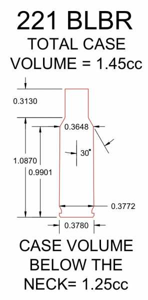

Brian,
     Why a .223 Short BR?  I thought the 221 BLBR (Brian Lewis Bench Rest) was a much more reasonable venture.  The 223 Short is just a little shy in velocity for BR work, I think.  After making brass and shooting the .223 Short for a while, I think you would be happier with the 221 BLBR for bench rest competition.  That give you the extra long (.313) neck you wanted, without sacrificing that much velocity.  Just my 2 cents.
Shane
Offline briannmilewis
  • Trade Count: (11)
  • Posts: 1017
Re: Scale Models
« Reply #6 on: June 08, 2011, 08:57:26 AM »
Shane: I just emailed you in agreement with that, for all the same reasons. It is not that I want to do BR shooting, just interested to know if doing a "BR" makeover could really effect the 221 FB accuracy. If it did, then we could apply it to target or varmint shooting. That would be a double win. I know there are plenty of variations of the 221, neck up, neck down blah, blah, blah...there is probably an improved version according to Ackley specs. I would also like to do the BR makeover of a regular 223 cartridge to see if that can be improved upon.
This would be easy to make from 221 FB brass or 223 Rem once fired. What is good about it is if we used 221 FB brass there would be no case trimming, just let the case length be whatever it is when the shoulder is set back.
